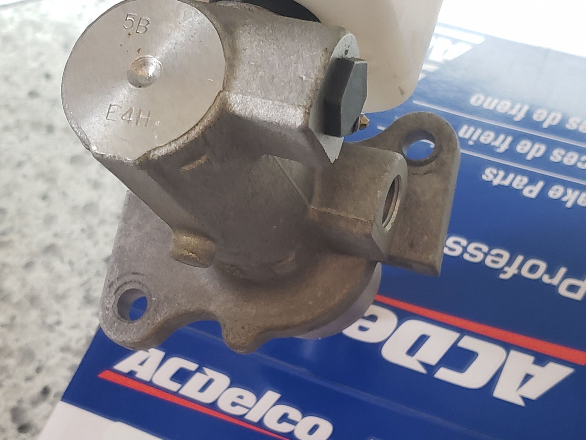

Im sure the topic has been discussed before. I have a 64 jetstar with a 330 which ive rebuilt and installed a mondello cam jm 18/20. Switched to a 4 barrel qaudrajet and im experiencing low vacuum. I have power brakes with a single master cylinder. I want to switch to a dual master cylinder and add a vacuum canister. I just want a straight answer which master cylinder do i need to workqwith my booster. Part numbers appreciated.

The dual master cylinder for a 1962-66 Cadillac bolts to your current booster and has a deep piston for the long pushrod in your current booster.

Will the above model work if i were to use a Cadillac master cylinder.
So, above I said 62-66 Cad, the applications for the M/C you posted are 62-66 Cad.

Ok i will go ahead and order it.
Master cylinder just showed up and it is definately wrong.
