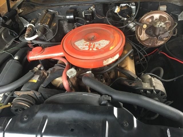

I know this was the case with Canadian Chebbies but I'm not sure about Olds: was the firewall painted body color instead of chassis black?
My 69 is black

My 69 is black
And it was built in Oshawa?

And my '68's Oshawa built are black as well as a few others.
Yes

65s were body color
