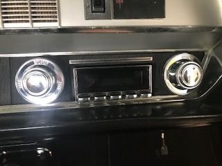

I finally got around to installing my new Retrosound Laguna Beach model along with an Alpine KTP-445U amp (45wpc) - while I was at it, I upgraded my front kick panel speakers to Alpine R-S65.2 - 6.5" coaxials (I have a pair of Morel Maximo Ultra 502 - 5.5" coaxials mounted in the upper rear convertible piston covers
The Retrosound radios come in pieces - you have to assemble the control head, brackets and operating shafts yourself but all of that only takes a few minutes to bolt together. The mounting brackets offer plenty of operating shaft locating adjustment room to center the radio into your dash opening. The operating shafts are fully threaded as well so you can set their depth in the bracket behind the dash to where the radio *****/dials sit near flush with the dash surface.
I tested the radio without amp connected first, just for sound quality comparison and to rule out any inherent ignition noise transmission (i.e. electrical whine) - without an amp it sounded decent enough for general mid volume listening (you really can't go cheap on speakers for any of these aftermarket radios or they sound flat / shallow). But the amp really richened it up to where even low volume listening was much more well balanced in bass/treble differentiation.
I also ensured everything was well grounded and installed noise filters separately off the radio and the alternator to ensure a noise-free audio output.
With amp set for mid-gain front and rear I can cleanly power the volume up well into the 30's without any notable sound distortion (a definite plus for topless road trips!)
Setting the radio functions (stations, sound and fader controls, etc.) is simple and for the most part I'm only using the AUX inputs for my console-mounted Sirius tuner and MP3 player.
