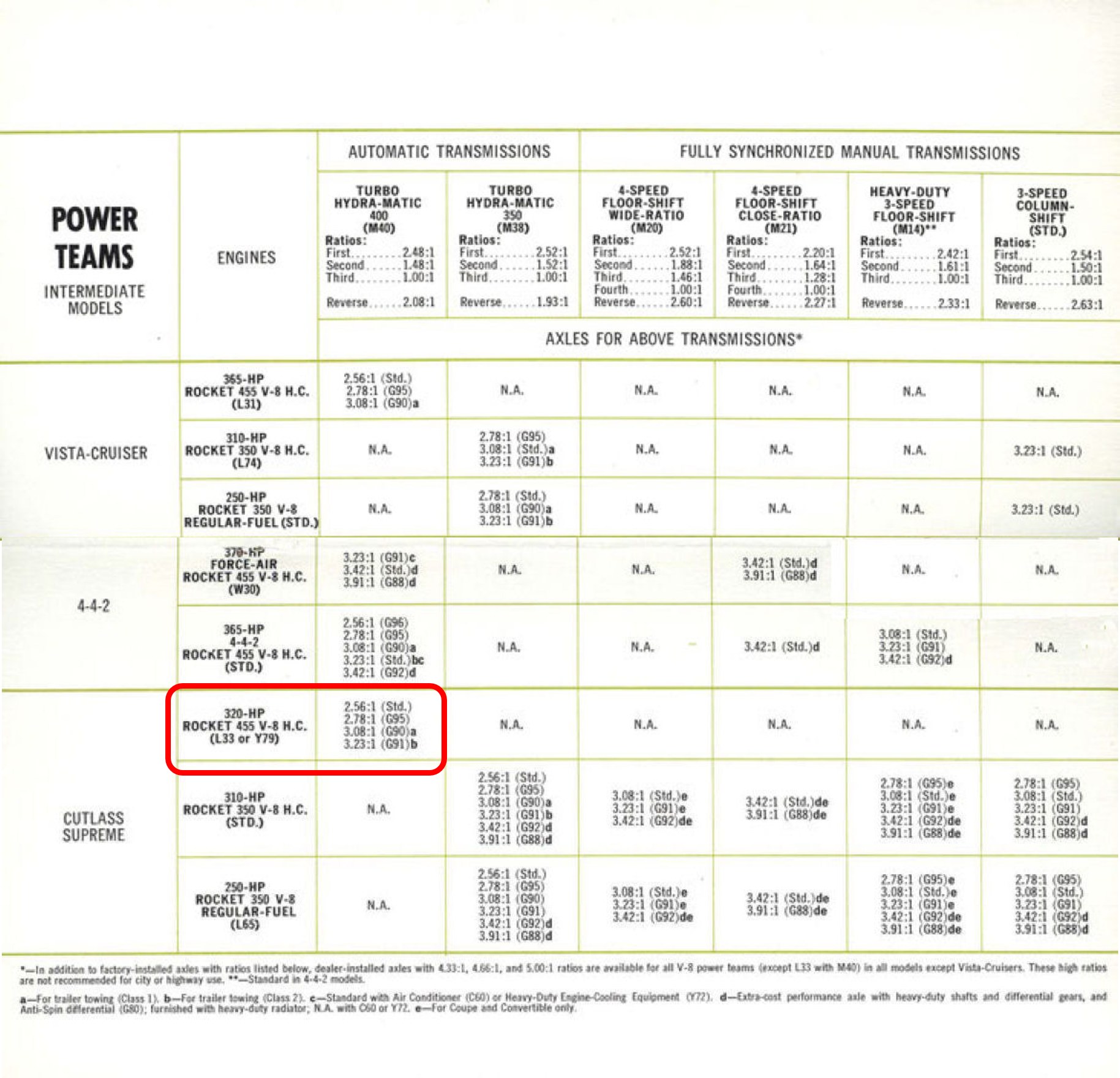

Old Jun 24, 2023 | 06:53 PM
From the 1970 Power Teams booklet:
Old Jun 24, 2023 | 07:27 PM
72455's Avatar
1972 U code Supreme
Posts: 4,100
From: Chesapeake, VA
I guess the point of my question is why weren't 4 spd 455s available in the Supreme for '70-'71, but they were for '72? Were 4 spd 455s only available in the SX for '70-'71, but not the Supreme?
Old Jun 24, 2023 | 07:37 PM
From the 1972 Power Teams page. Keep in mind that for the 1972 model year, the only way to get a 442 convertible with a 455 and four speed was to order a Cutlass Supreme convertible with the W29 option and the appropriate drivetrain. Had the 455/4spd not been available in the Supreme that year, it would not have been possible to get a big block manual trans 442 convertible. Lesser Supremes benefited from this fluke as a result.
Old Jun 24, 2023 | 07:39 PM
By the way, because of this loophole, one could have ordered 455/4spd Supreme Holiday Sedan in 1972.
The SX came with a T400 only, no manuals. Only way to get a manual trans in a Supreme for 70-71 was to get the 350 motor. Cant say why GM did it this way, but would bet that Olds wanted people to buy the 442 if they wanted a 455 4Speed.

Thats cause they didnt offer a 455 manual trans in a 1970 or 1971 Cutlass Supreme. Only 350 cars could be ordered with the 3 or 4 speed manual
