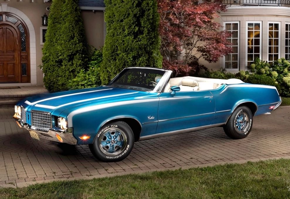

Here's mine:

Originally Posted by Rickglick
I love the hood scoop and that you painted the grille center black. Custom without being gaudy. Very sharp!
Here's mine:
Thank you for the compliment, but I can't take all the credit. What you see is how it was when I bought it. I only added the wheels (came with the car) and tires. Besides, my hot rod pales in comparison to your beauty! Your photo captures it perfectly!
I hope you take advantage of every opportunity to enjoy it, cuz I know I would 😀
Thanks! I do enjoy it-230k miles! I did a lot of mods. you can see in my gallery.
That photo technique is called 'light painting'. It's taken in complete darkness. you open the apeture on the camera for about 8 seconds while waving an LED light over a certain area. you repeat the process about 50 times and then layer the shots. takes a long time, but the result is sort of '3D'.
