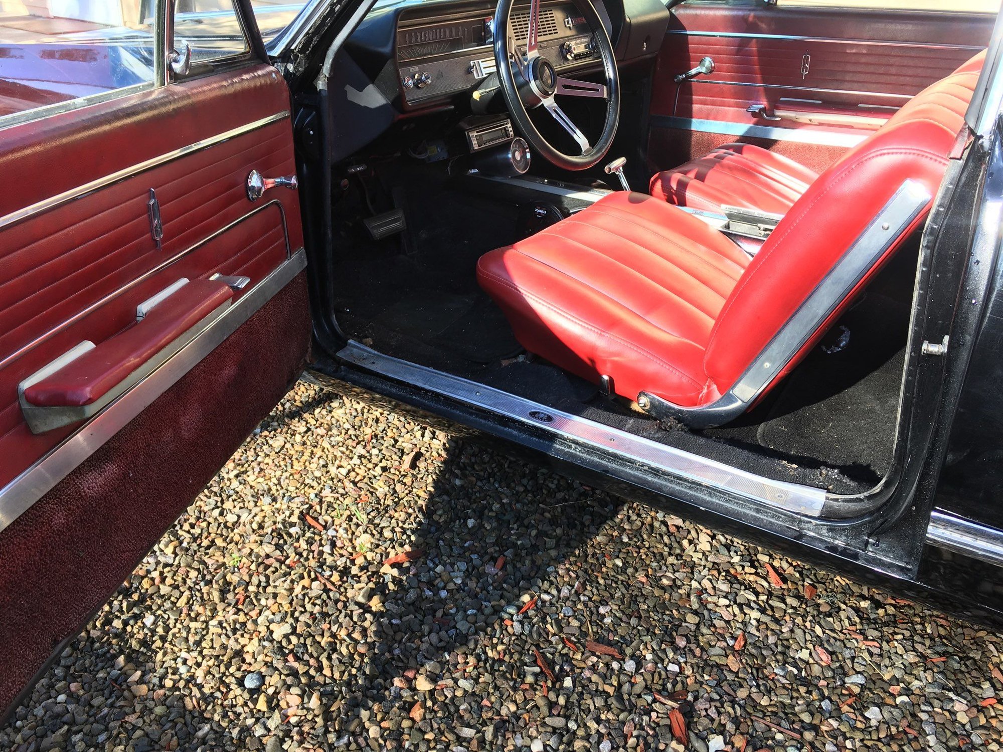

Thank you sir. It du help the car has had some serious revamp. The interior has changed and the exterior has been changed as well. There is no ac present . It does have buckets and floor shifter. No defroster.
