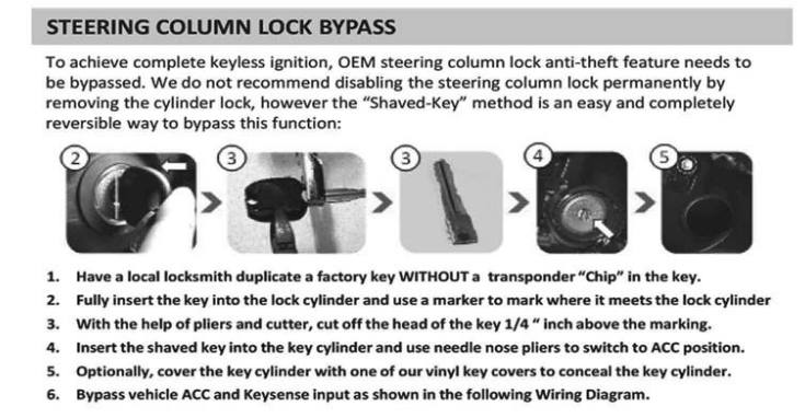

Here’s kind of what I’m looking at—there’s a great video I found online that shows the system in action.
It’s exactly the kind of setup I’ve been thinking about—simple push-button start with solid security. I like how it doesn’t just look clean but also solves the whole key ignition hassle. Here's the link if you want to check it out: 👉https://www.digitalguarddawg.com/key...omotive/pbs-ii

If your car is 1969 or newer, you still need the key to unlock the steering column, so what's the point?

I would not do this mod a 70 Cutlass.

Don't do it, as Joe mentioned above. Also,YOU will be relying on this after market electronics to engage your starter & wake up all the electronics. I can not tell you how many times cars get towed into our shop with this kind of mickey mouse junk that stops working..You have been warned LOL.

JOE, He could remove the pin from the steering lock. But your right don't do it..

The term "half-fast" comes to mind when reading the instructions...
But hey, let's make the vehicle less theft-proof while increasing potential failure modes and paying nearly $700 for the privilege. Good plan.
Actually, upon reading this again, the instructions say "Turn to the ACC postion." On a GM, that still locks the steering column, so I ASSUME you would need to turn it to the RUN position. This doesn't bode well for the accuracy of the directions.
