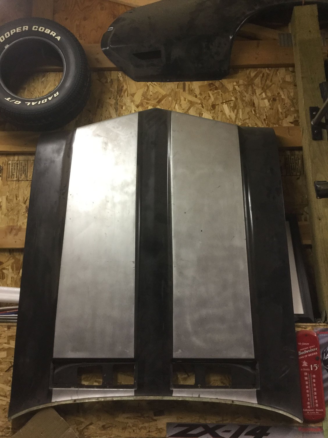

Hanger for the hood on the back side.
My spare hood hanging on the wall.
My ceilings are much higher but if you can slide them up through the rafters ? but they may still hang to low. I made a hanger by cutting a piece of c channel (about 3 inch ) so it would fit into the square slot on the underneath side of the hood. Drilled a 3/8 hole on the opposite side of what fits into the hood and ran a carriage bolt through a good 2x4 about 18” long. Deck screws hold the wood to the wall and a good friend to help you lift them.
Worked better than the first try which was just a lag bolt through the steel into the wood. That’s how it got the damage at the back of the drivers “ racing stripe ”.
