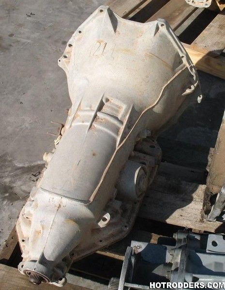

I have heard rumors of a Chevy-only 200-4R case but have never seen one. I do know that the early 200-4Rs were BOP-only. By 1986 ALL 200-4R cases were unisex. I suspect that person is thinking of a 700R4.
Here's the BOP-only version.
