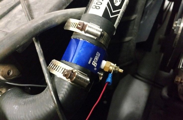

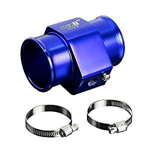

You can also do this:
On my '78 Toro, the temperature sensor was built into the ignition system. That stopped working long ago, so my car had no temperature sensor at all, neither gauge nor idiot light. The port on the engine where it would normally go had a plug screwed into it that not even Superman could have loosened, so I just left it and put this in instead. It connects to a gauge mounted under the dash and works very well.
It may not have the "optics" that you might like to have when you open the hood at a car show, but if you want to have a temperature gauge along with the idiot light, don't have an available port on the engine, and don't want to start drilling and tapping into the engine, this is one way to go.

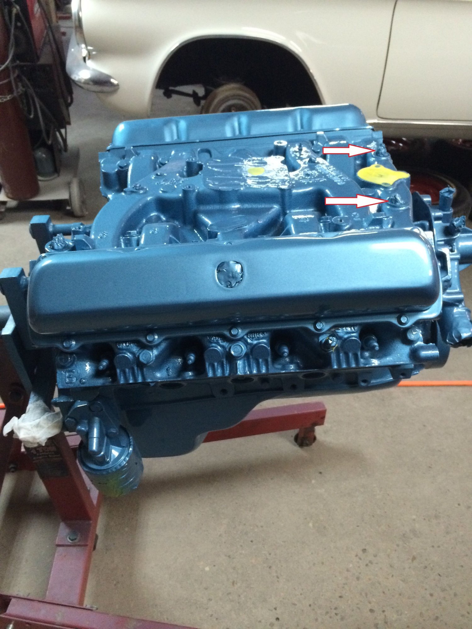

Thanks to everyone for your comments. After reading Eric's post I pulled up a pic of the manifold and it looks like there is a second threaded port to install the idiot light sensor. DUH! I don't know why I didn't pay attention to that before. Does anyone have a part number for the sensor? My local part stores say it's not available to them. Need the one for a light not a rally gauge.
