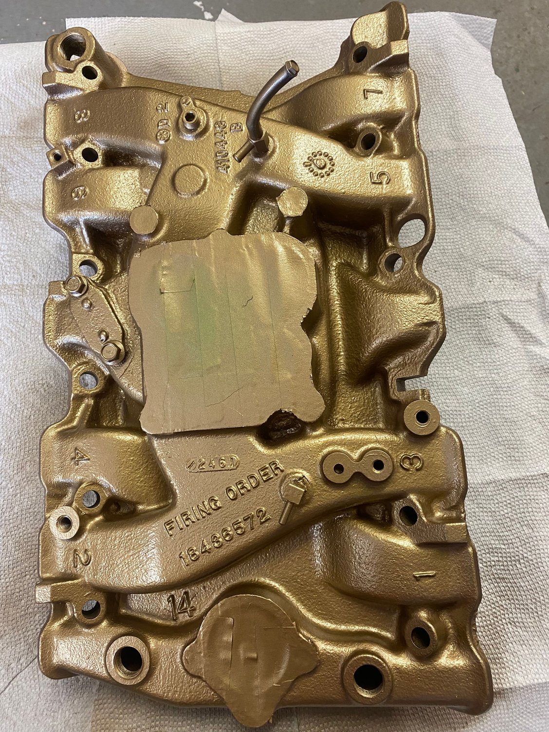

Not sure if this pic will help but here is the intake manifold in question

intake
404520 '70
398583 '70-'71 350 2V. Iron.
407564 '71 350 2V. Iron.
12 407565 '71 350 4V. Iron.
4085520 '71 350 4V. Iron.
13 410670 2V. Iron.
14 410446 '72

looks like the original !4 for 72

Originally Posted by lunaboy
404520 '70
13 410670 2V. Iron.
14 410446 '72
perfect ! That’s what I needed thank you
My question: what numbers can I look at to determine if this is in fact the original manifold? Or does it even matter? Thank you

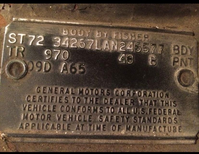

There is nothing on the intake that will prove it's the original. The best you can do is verify that it is the correct casting number and has a casting date within the range appropriate for the build date of your car. 410446 is the correct casting number for a 1972 4bbl 350 motor. That 246 casting date corresponds to Friday, Sept 3, 1971. That would be a reasonable casting date for a car built between mid-Oct 1971 and early Jan 1972. What's the assembly date on your cowl tag?

So if if my cowl tag memory serves me this car was built forth week of September?
Old Mar 15, 2023 | 11:58 AM
Posts: 26,056
Fourth week
That's actually within the range. Usually components are expected to have date codes 1-3 months prior to the car's assembly date. Given that this is early in the model year, late Sept is also within the boundaries.
