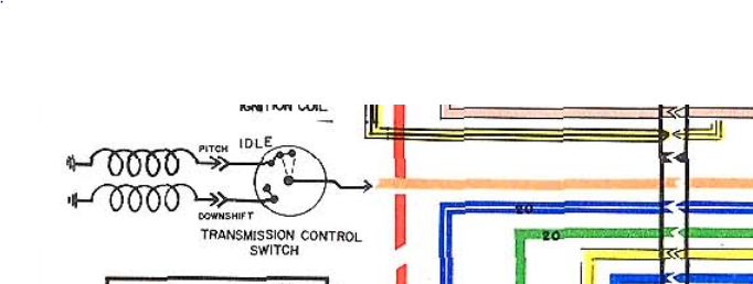

Switch
62 Olds 88 - Saw this on my wire diagram & do know ware to find it. Help
Old Apr 15, 2021 | 05:11 PM
Yellowstatue's Avatar
Posts: 4,086
From: Too close to Toronto!!
It is hiding inside your transmission, behind the electric plug, left side.
Old Apr 15, 2021 | 08:59 PM
Is that switch not on the throttle linkage like the Abody switch pitch controler?
Old Apr 15, 2021 | 10:08 PM
rocketraider's Avatar
Oldsdruid
Joined: Dec 2007
Posts: 10,629
From: Southside Vajenya
To my knowledge there is neither electrical downshift nor variable pitch stator on any 1962 Oldsmobile HydraMatic transmission.
I'm not even sure the baby Dynaflow used in the Buick Special had a switch-pitch in 1962, and Buick was experimenting with it at that time.
Old Apr 16, 2021 | 05:10 AM
You'll find it on a 1964-67 Oldsmobile, which means that is not the correct diagram for a 1962 car. Olds didn't start using an electric solenoid kickdown and converter pitch system until the 1964 model year on the Jetaway trans.
