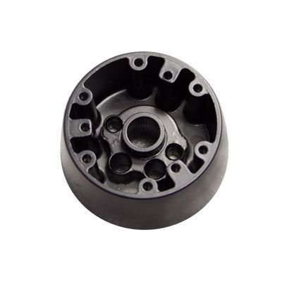

While it wouldn't be correct, you can install a four spoke wheel on your 65. Use the smaller diameter hub from the 1964-66 Impala with the two spoke wheel. This is available from the Chevy repro houses. Note that this is not the same as the hub used on the three spoke wheels.
https://www.impalaparts.com/6466SWH/
Old Aug 17, 2023 | 07:56 AM
I like this idea sir. YOU GUYS HAVE A LOT OF KNOWLEDGE...
