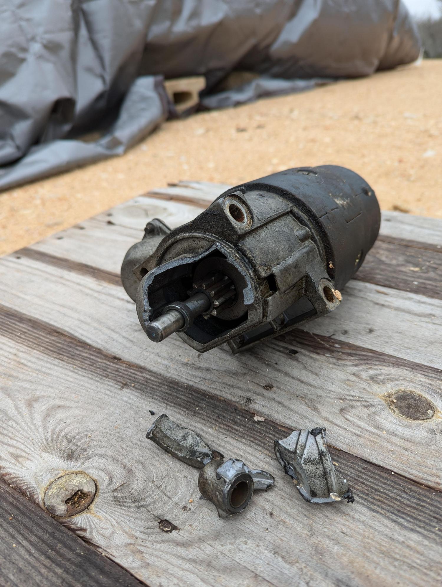

I heard a loud noise at an attempted start up on my 69 442 but has a 71 455 engine. It didn't start and sounded like the starter exploded, it has a new battery so I pulled it and it tested fine. I did notice a crack and I'm wondering if this crack could be the cause? Is it possible the crack has the starter unbalanced causing the noise?

Absolutely. That needs replaced before it does explode & fall off. Not sure what caused it (metal fatigue?, poor metal alloy?). Whatever....
Thanks Norm, it may be fatigue it is a Delco possibly the original?

When the drive gear (pinion) connects into the flexplate/flywheel, there's significant torque applied which can easily cause the housing to go South on you in a hurry. Don't know the manufacturer. Whoever is the manufacturer, the starter requires replacement for many reasons.
Unless it's replaced, you could be looking at this in the not too distant future....

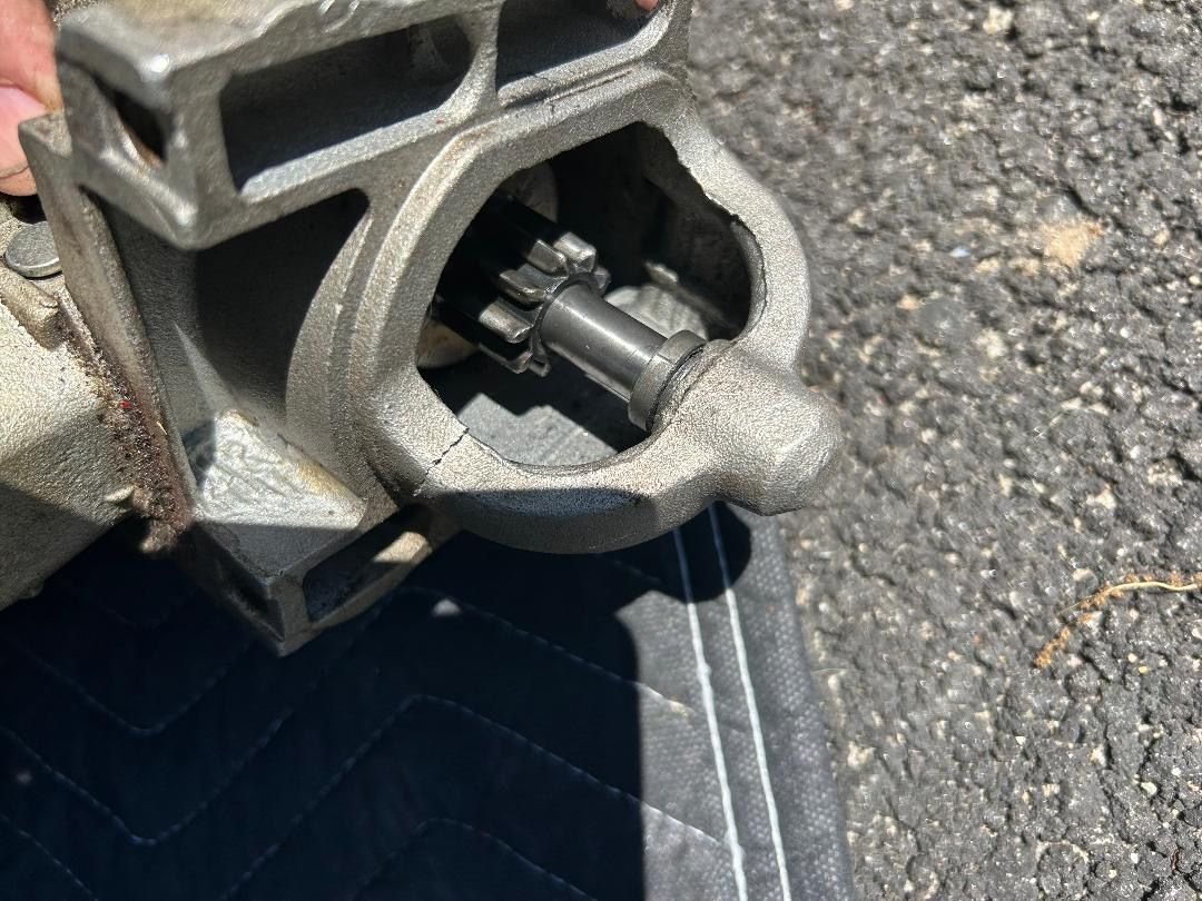

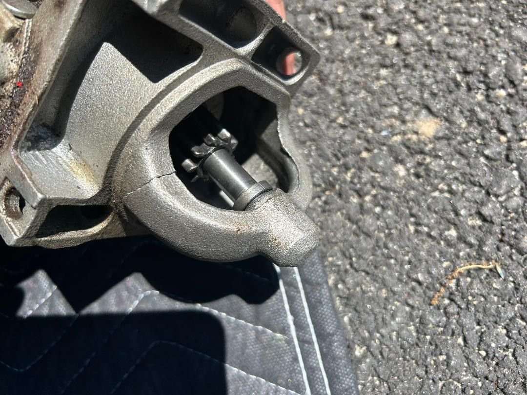

I see you replaced it already, but did you see this crack? Or am I seeing things?

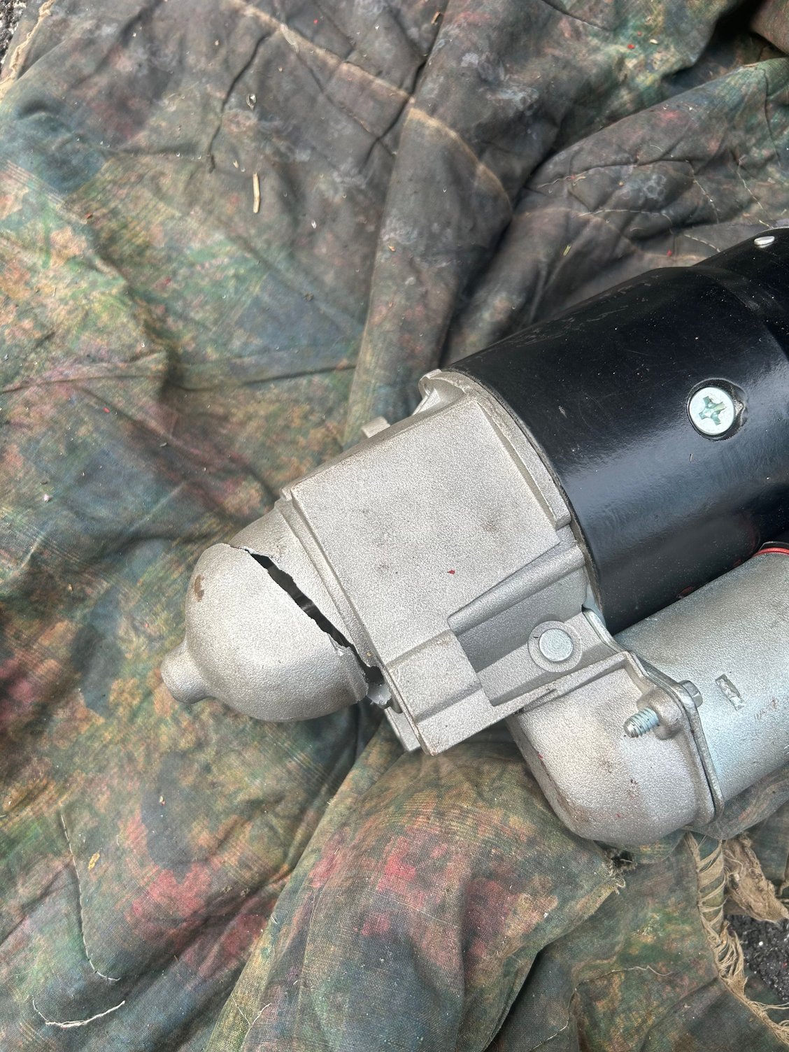

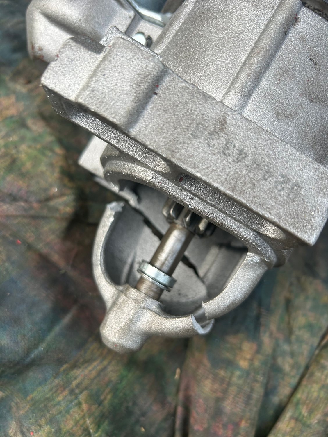

Well that didn’t last long, lol. Time for a powermaster.

In my experience the two most common issues which result in the nose cone cracking/breaking are: (1) misalignment & (2) misalignment.
I guess, but it only goes in one way unless you mean adding shims. It was starting fine and then this morning in the middle of starting it just started spinning. The old starter was in there for years without issues or shims. I understand rebuilt starters are a new cast and sometimes shims are needed, but again it was working without any funky noises.

As has been mentioned: (1) Use a brace. There's a reason the brace was designed to support the starter solenoid to the engine; (2) Clean the threads well very, very well & install with new knurled starter bolts.

1. New re-manufactured 9.999 of 10X today = chineasium landfill junk...exhibited in post #1 & 20-21
2. Nothing will survive if the starter is not installed properly and or the flywheel/flex plate is bad.
Have you looked at the pinion gear engagement on the flywheel. Physically actuate the solenoid manually and check gear mesh. Is the flywheel/flex plate in good condition? Bent, missing teeth etc.
3. Get an old GM starter have it rebuilt by a local rebuilder. Anything else you purchase stands a great chance of being land fill....mini or full size.
This is the proper support bracket for a 69 442 and a 71 455.
