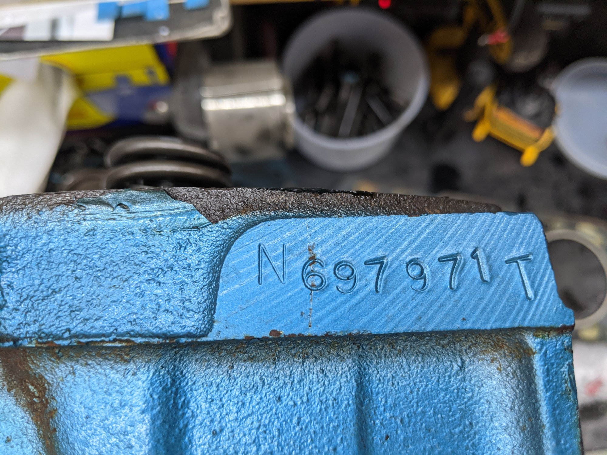

Can anyone identify this stamping on the side of a cylinder head? This is a B head. I have a few other heads and they don't have anything like this on them. The heads are somewhat mystery heads as they were redone over 25 years ago and I believe they had a lot taken off to increase compression.

I think that's a 66 Toronado head.

just the front of the passenger side head was stamped 1965-'67 (maybe earlier ??)
N-prefix (engine unit number) T-suffix = 1966 Toronado 425

^^^This.
N = 425 4bbl motor
T = Toronado application
The other digits are just the engine sequence number. This number would have appeared on the Protect-O-Plate for the car it came in, allowing you to trace this engine to a VIN for warranty purposes.

Okay, thanks for the clarification I have not noticed this on heads before. I pulled them off a 66 or 67 Toronado in a junkyard many years ago.
I take it all heads were not stamped? I have 2 sets of E heads with no stamping like this on them.
I was hoping it was a stamp from the machinist that worked on these heads and told me how much was shaved off.

Pre Jan 1 68, the engines were stamped, on the head, front side, of the passenger head with Letter Code [Engine Number] Sometimes another letter. Since the heads are identical, 50% of heads got no stamps, being on the driver's side.
Once the Federal requirement to stamp the vin derivative on the engine occurred, that took over for engine ID, and that's on the block pad under the front of the left head.

Actually, Olds made the change at the start of the 1968 model year in mid-1967. All 1967 model year and older Olds engines have the engine unit number stamp on the front of the passenger side head. Note that if the heads have ever been off, there's a 50-50 chance they were swapped at reinstallation, which puts the stamp on the back of the driver side head.
All 1968 model year and newer Olds engines have a VIN derivative stamp on the block. In addition, there is an engine unit number stamped on the oil fill tube. The first digit of this number on the oil tube is the model year.
