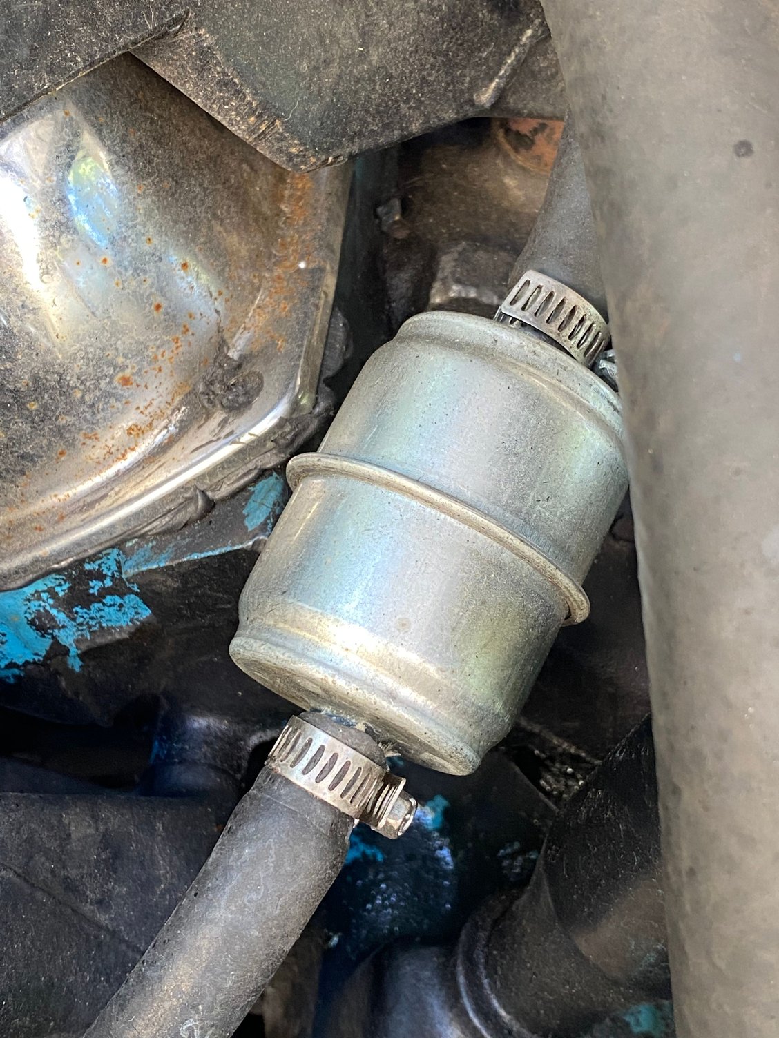

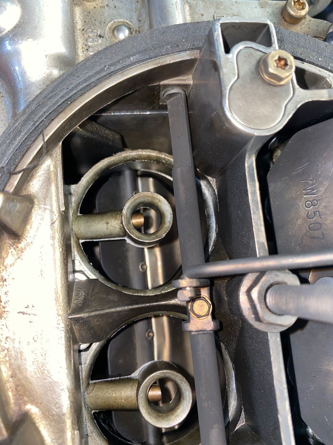

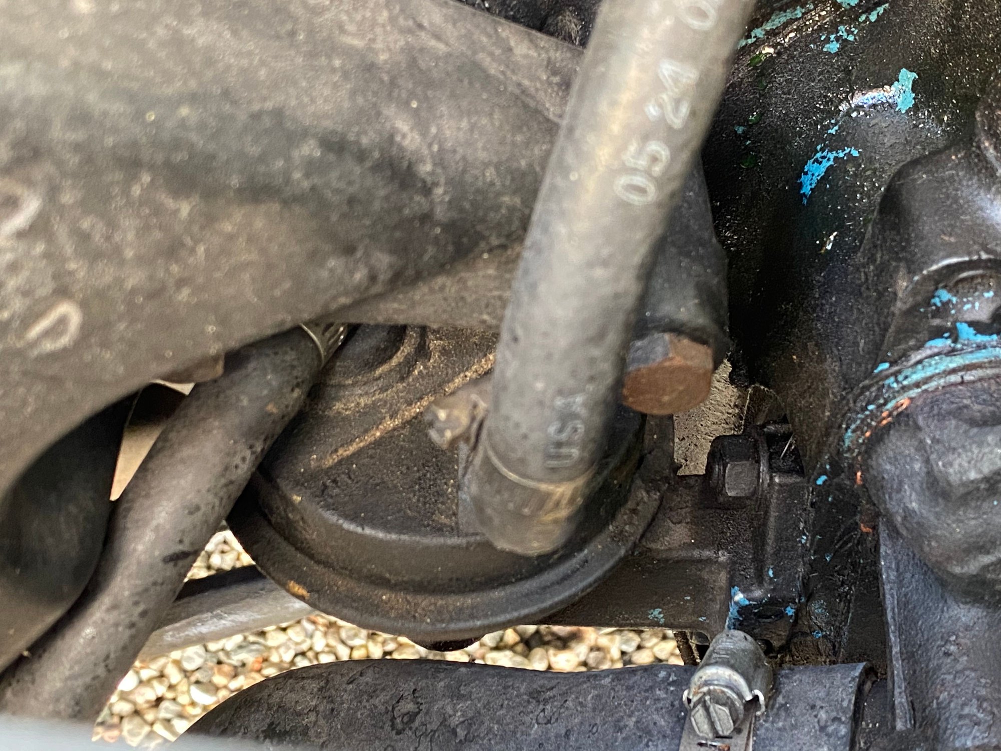

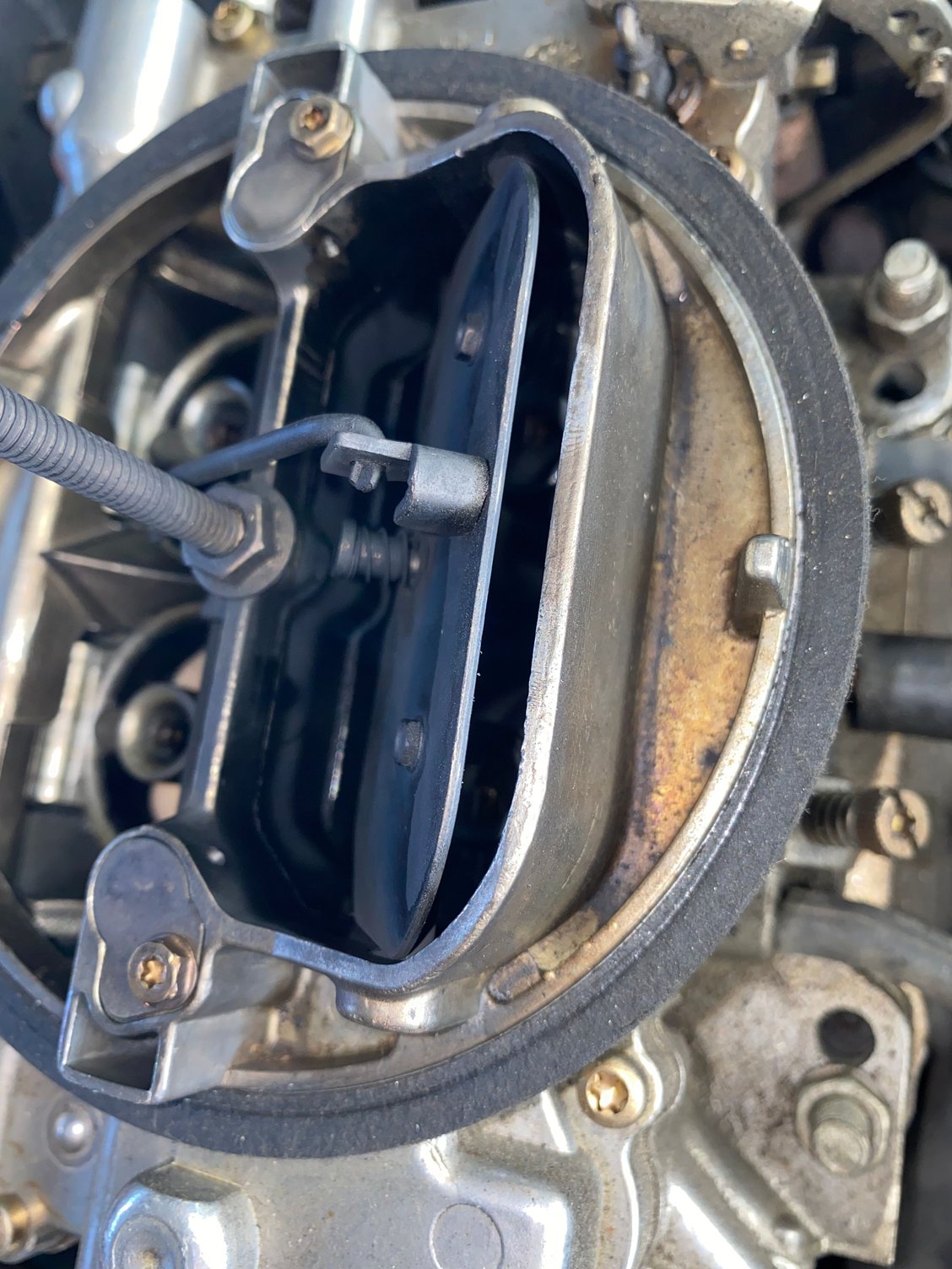

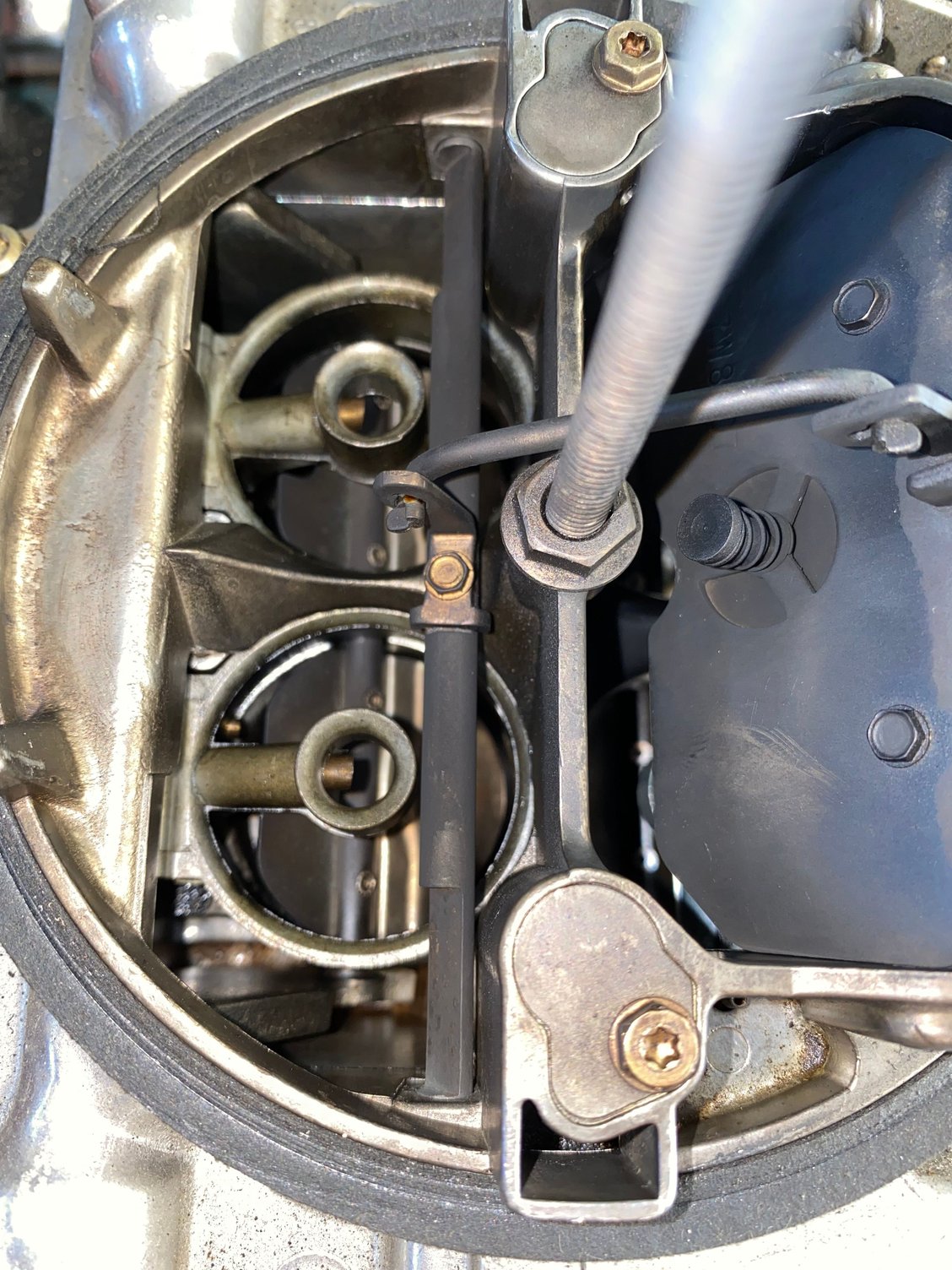

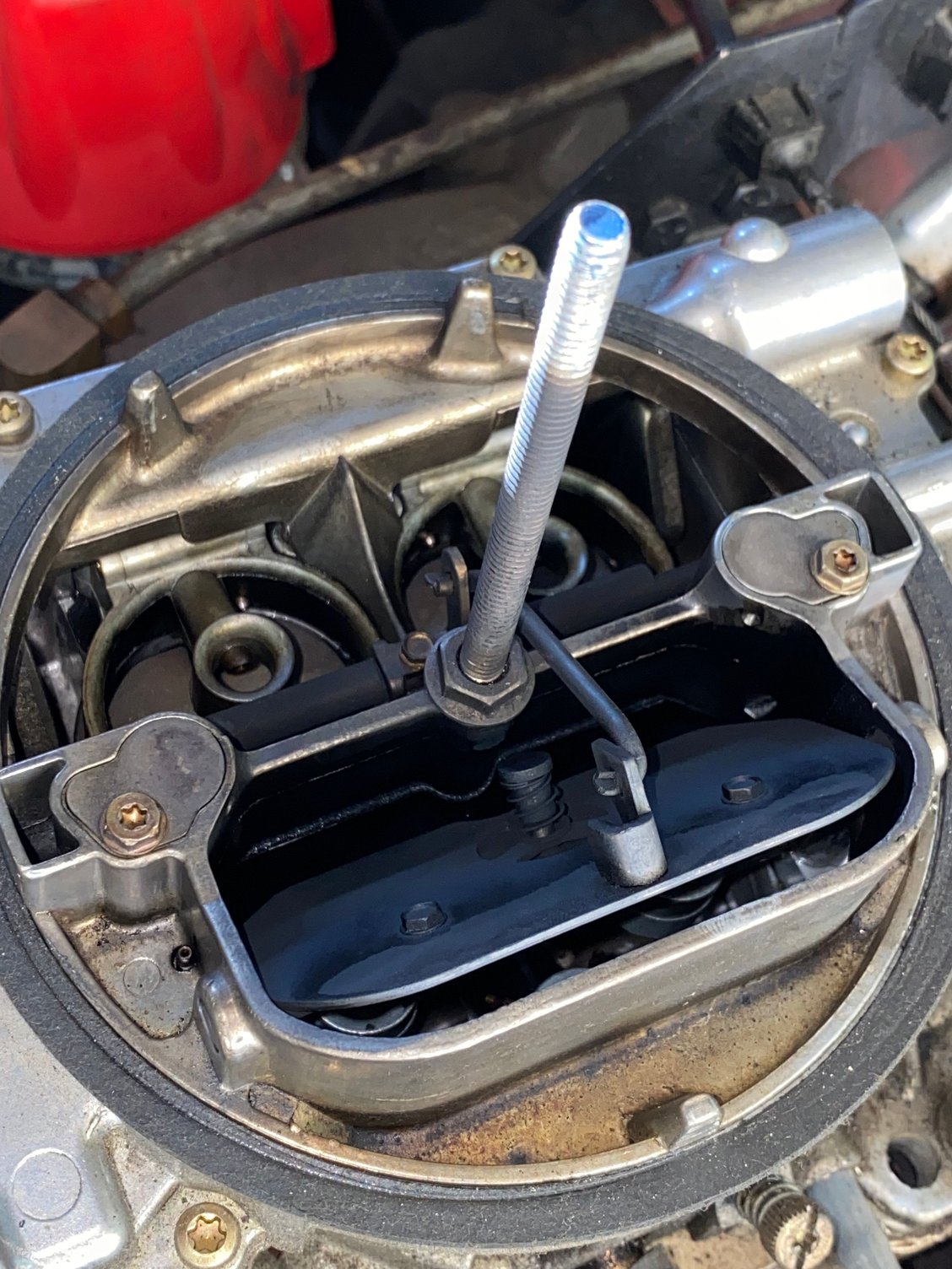

It comes from the carburetor (hoses are ok!)
With the insurance inspector, i found that the car has a 4 barels, not a 2! Sweet lord!😂
but, after inspection this morning, on my belly and back, all hoses are ok.
Charcoal recipient could it be in aluminum?
Gas smell come strongly from carburetor after removing the air filter. ( Didn’t catch the covid! Lol)
anything to recommend? Adding pictures!
Awaiting 200$ of books from ebay by the way! 😉

There are three gaskets on the Quadrajet. From the top down: (1) Air Horn gasket between the air horn & carburetor body; (2) Throttle body gasket between the carburetor body & the base plate of the carburetor; and, (3) the base plate gasket which mounts the carburetor to the intake manifold. Any of these gaskets can become soaked with gasoline over a long period of time for any number of reasons (a) sometimes the fuel float in the fuel bowl is set a little too high and fuel seeps after shut down or during operation saturating the gasket; (b) evaporate fumes eventually condense onto the gaskets & soak the gaskets; (c) the carburetor bolts holding the carburetor to the intake manifold become loose & fuel saturates the gaskets; &/or (d) the gaskets eventually wear out. If any or all the gaskets become soaked with fuel you may to change any or all the gaskets - a simple job and gaskets are readily available. Gaskets saturated w/ fuel take forever to evaporate and may never evaporate all the fuel saturated within them. Ensure the carburetor bolts tightly secure the carburetor to the intake manifold.
Ensure the fuel filter housing/fuel inlet line is secured tightly to the carburetor.
Old Jun 25, 2021 | 08:11 AM
Posts: 12,800
That's some sort of evil Edelbrock copy of an AFB or AVS, I think.
