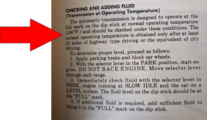

Here's a thought. Rather than debating this, why don't we just READ the Chassis Service Manual?
Here's another thought, the op didn't mention a specific make or model. So without that information the debate has always been a headless horse.

Yes, you are right as Joe points out here. But there is a range on the stick, cold is the bottom mark on the cross hatch, idling in Park on GM vehicles. Yeah, the ZF 8 speed in my Challenger has no dipstick. It has to be between 86 and 122 degrees max. It should trickle out the fill hole running in park on a level surface.
