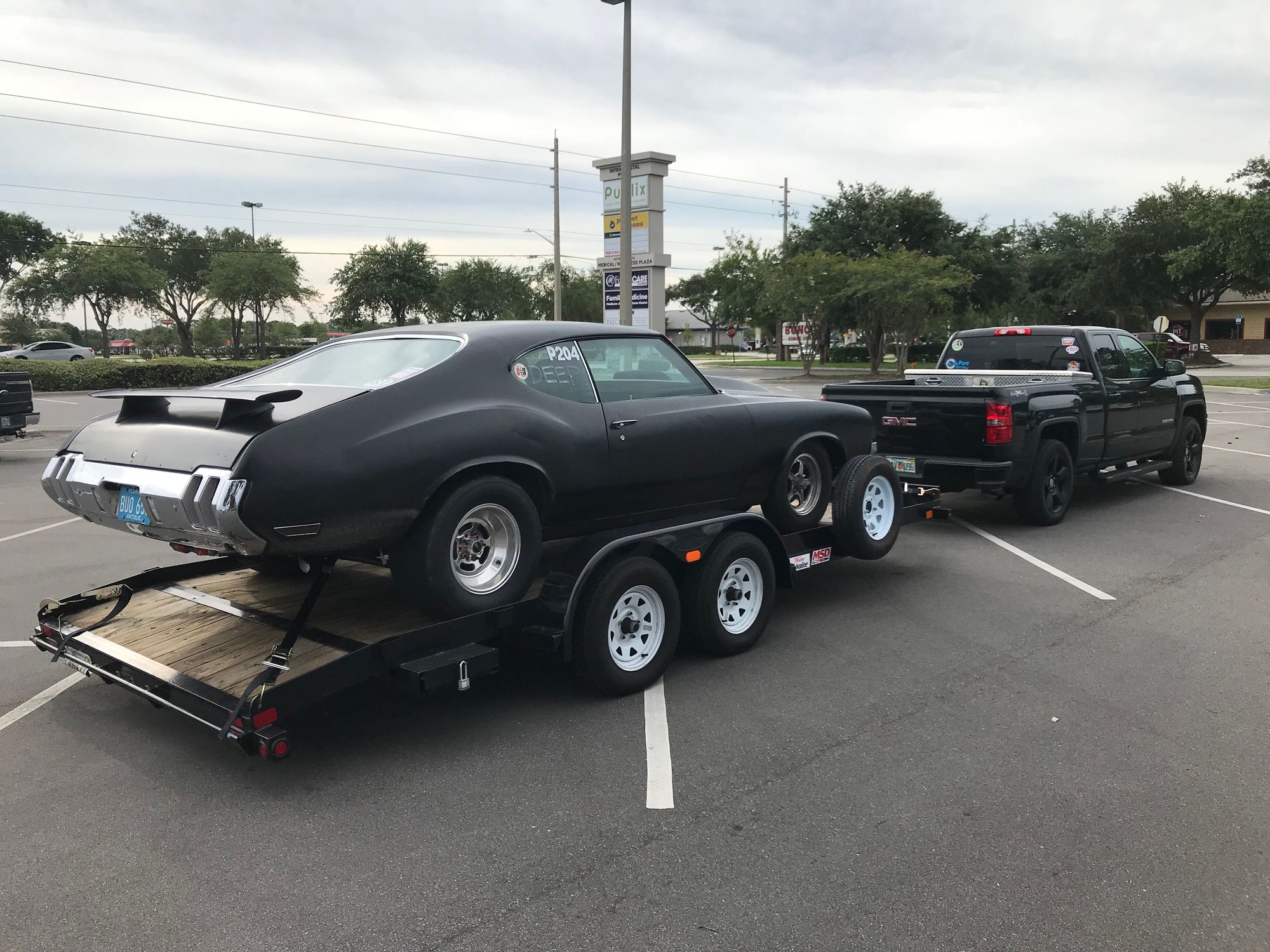

I don't have a pic of my 68 but this give you an idea. This is my dad's 87 Mustang the night I brought it home from my parents house. I should have crossed the rear straps. The fronts were too close to cross.
