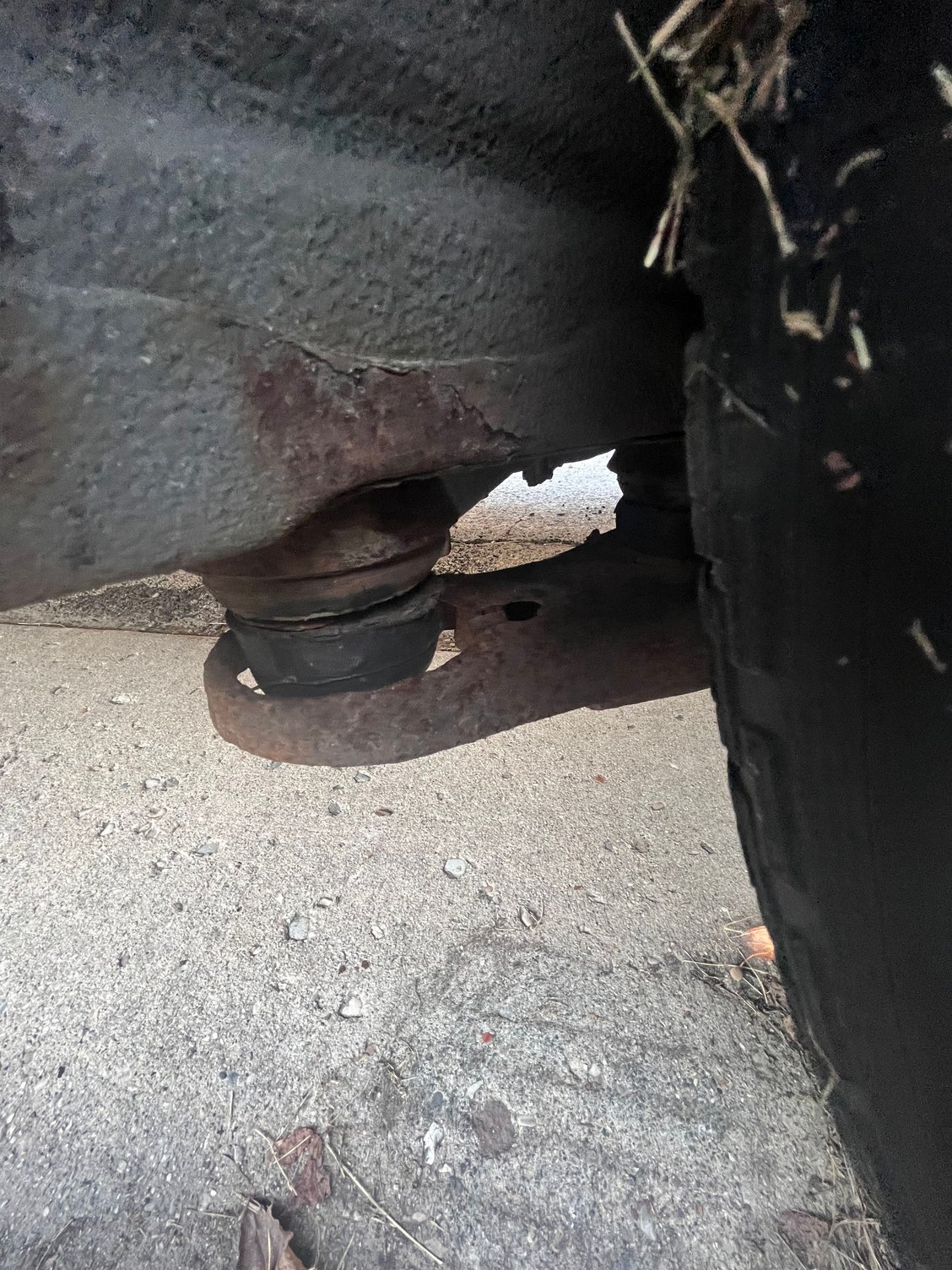

Rusted subframe on a late model 98
[QUOTE=Jbreunig;1365655]For Sale, located near Madison WI, 1996 Oldsmobile Ninety Eight Regency Elite
[/QUOTE
Hello, do you have any pictures of frame? My son has one of these and the frame has rusted through. Thank you]

I moved your post to a new thread. I doubt the OP of the other thread still has the car (even though he was asking a bit much given that the AC didn't work).
The late model 98s (C body) and 88s (H body) would sometimes have rotten subframe bushings that could even fail catastrophically. Especially up north.
The proper fix is to soak the bolts for the subframe bushings with your penetrant choice (PB Blaster or Kroil). Then drop the subframe and replace the bushings. Hopefully you won't have to get another subframe from the salvage yard.
Here are some replacement bushings.
https://www.summitracing.com/parts/rnb-924-043
Here is a website to use if you need a subframe. 98s, 88s, Buick LeSabres, etc. should all be the same.
http://www.car-part.com/
I wanted to do this repair on the 96 98 I had. It's quite an involved repair though, hopefully you have access to a car lift. Fate had other plans for my 98, I had to scrap it.
