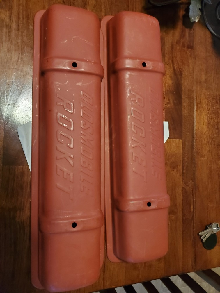

Hi, as a little side project to keep myself busy during the winter when it's too cold in the garage, I've begun to collect and restore different valve covers to keep as wall hangers. This past week I found and bought this very clean pair of Rocket covers off evilbay. Just doing a little Googling, it looks like they're off a '54-'56 324 (no ribs on the ends). Just curious what the proper colors are and if there would be something close that'd be readily available from Duplicolor or the like that a guy could get at the local parts stores? Also wondering if there was any different versions/colors for the 2 barrel VS 4 barrel, etc. Thanks for your time!

Are the real Olds Rocket covers or the SBC knockoffs that just "say" so?

They're real deal 2 centerbolt covers. I posted pics but they disappeared for some reason, let me try again.

These would be real since the Chevy knockoffs are 49 and 50 style and have the spark plug wire looms in them. These should be green with yellow lettering. Fusick has the correct color in spray cans and has the correct decals. The originals did not have decals but were painted with a roller.

Glenn, is there a color that you know of (or anyone else) that's a close match to the original green that would be available from Duplicolor or something like that? I've got all the main auto parts stores here in Missoula where I live and they don't need to be "perfect", but if there isn't anything even close I'll get the paint from Fusick. Thanks!

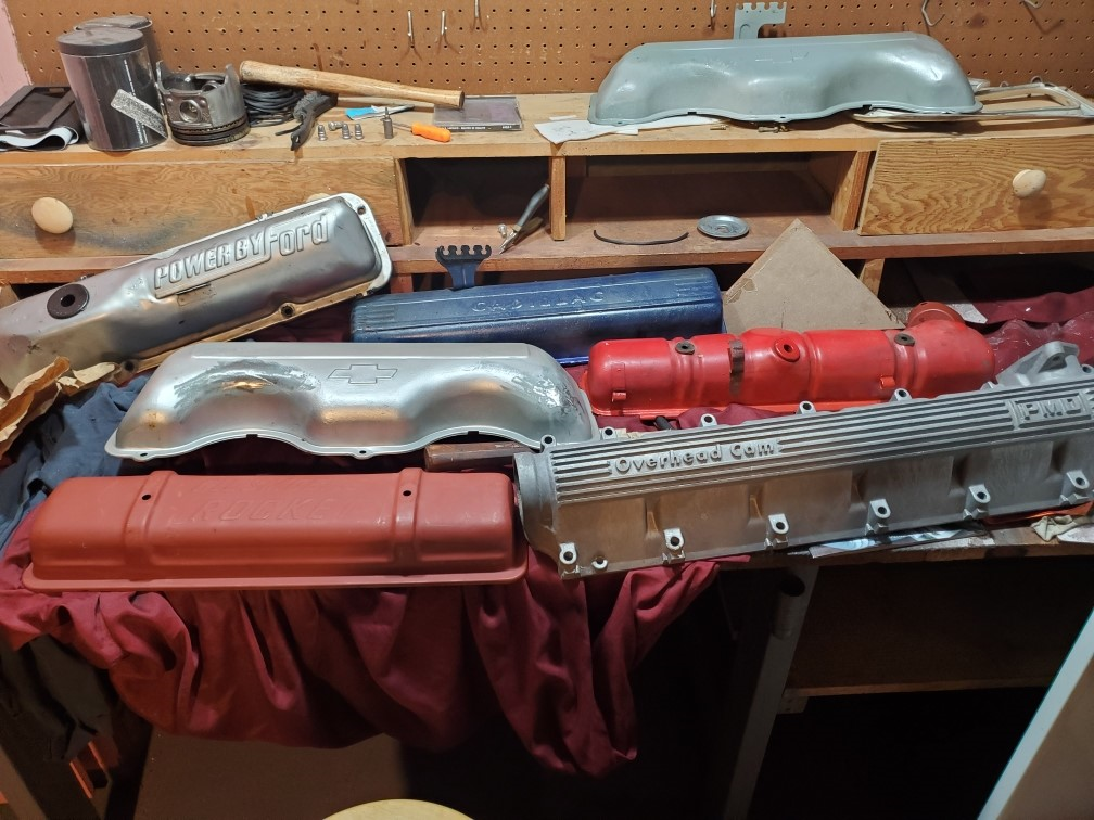

Will do, might be a few months but I will update. These are my most recent purchase but they're in the best shape so they'll be one of the next pairs I get done.... Too busy enjoying the perfect 75 degree weather here and driving the cars before things get nasty in a month or two

Nice Pontiac OHC cover.

Buddy of mine is into them and sent that to me as a gift. Super cool engine. Debating on painting it Pontiac blue and just polishing the high spots or polishing the whole thing.

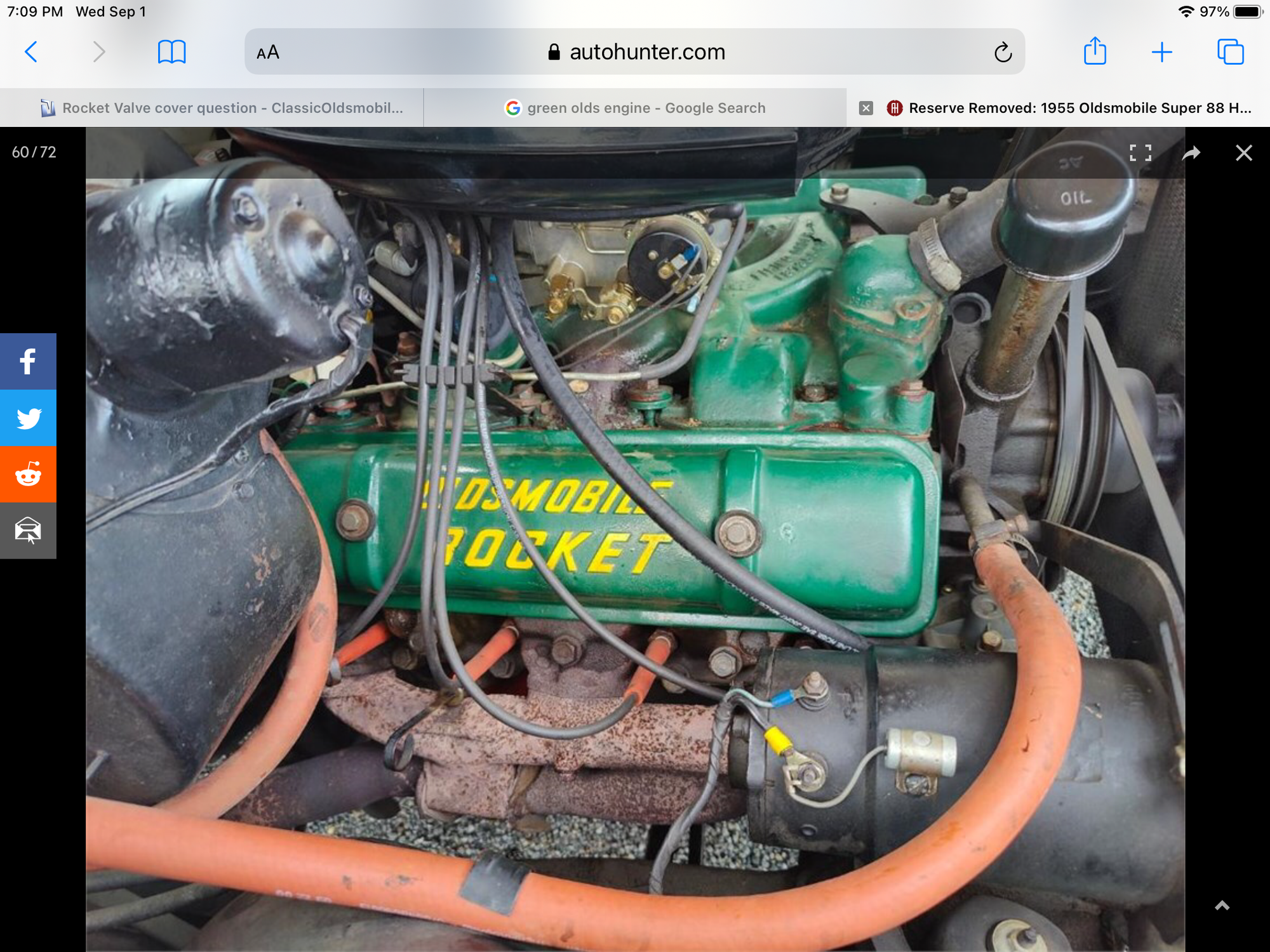

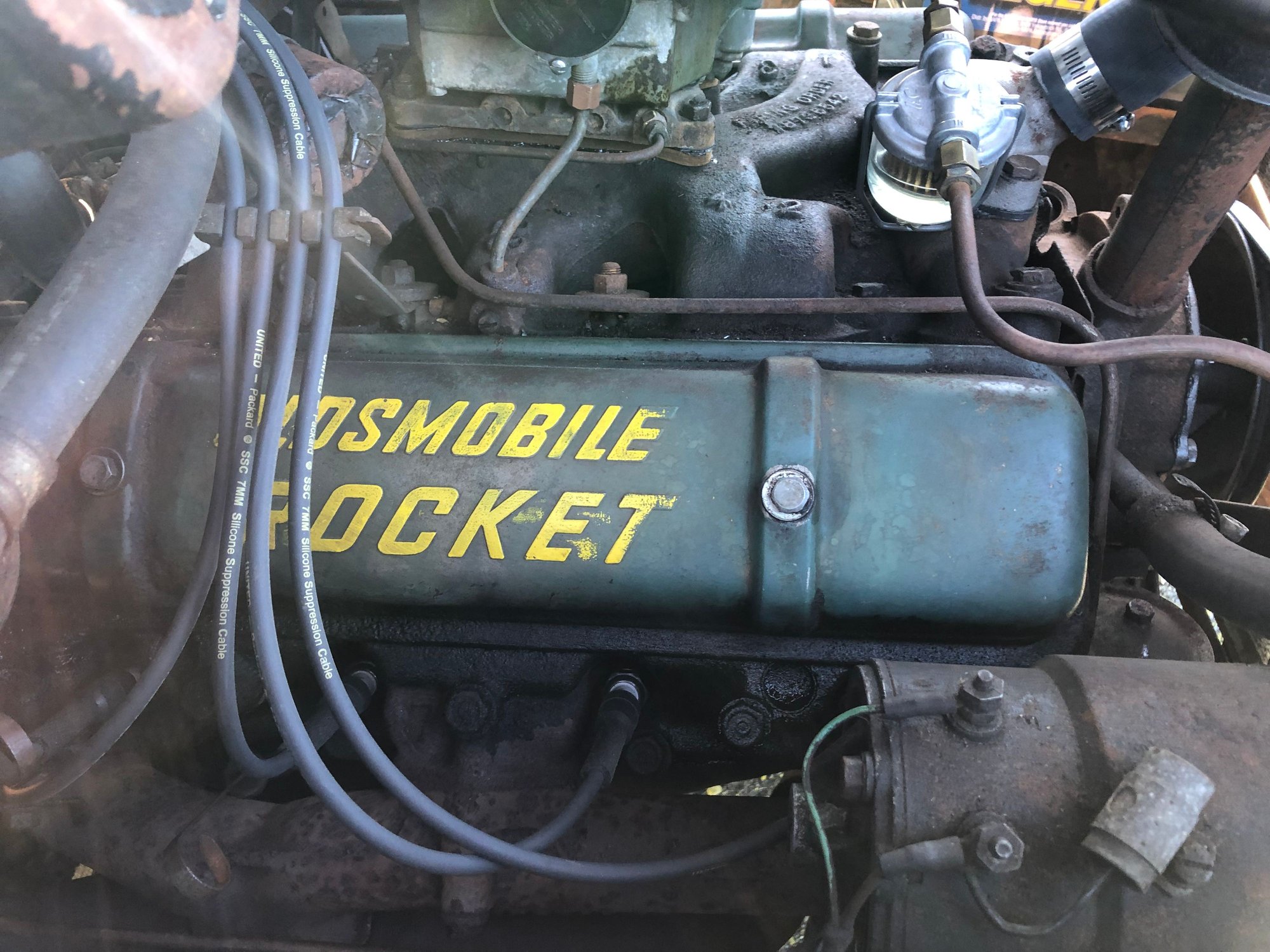

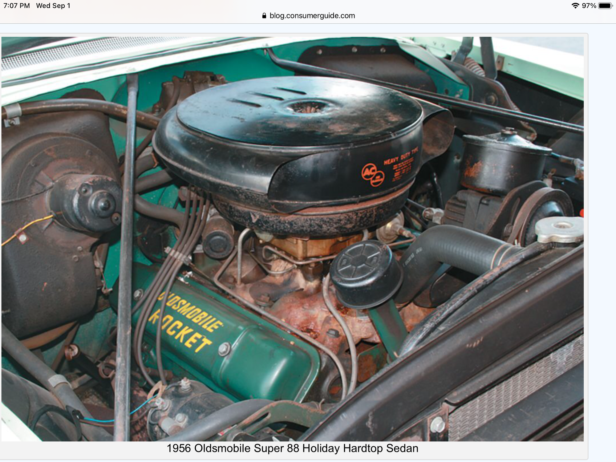

I don’t know which color is “right” but here’s a few choices I found.

From personal experience I can tell you the second and third ones are the correct color. First one is way off.

The yellow can be found at most auto paint stores in the One Shot lettering line 130-l primrose yellow. It is a very close match. The green I had a color match and I don't have the formula anymore but it would be worth it to sources from Fusick. As stated the last two pictures are closest but sometimes computers don't give good duplation of colors....Tedd

I agree. And the original Chrysler Hemi "Firepower" covers are cool. I also love the 348/409s and scored that set in the pic for $70, probably the cheapest pair in existence when I got them.

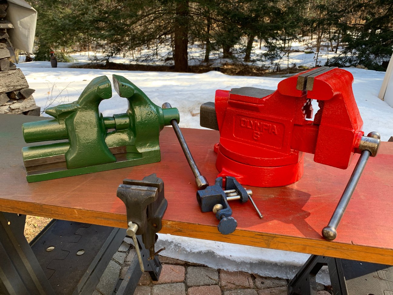

this green vise is oliver tractor green w a little stainless spritzed in it
tractor supply had some decent spray can paints including JD and this oliver one
https://cimg9.ibsrv.net/gimg/classic...0cd6312af.jpeg

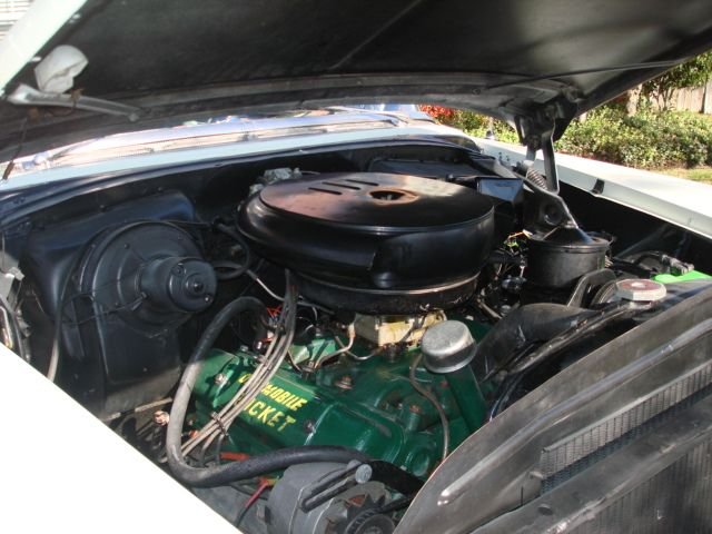

No question it has neve been restored and you can barely tell what color the engine is. Here are a couple pictures of my engine and the valve covers were painted with the correct engine paint from Fusick.
