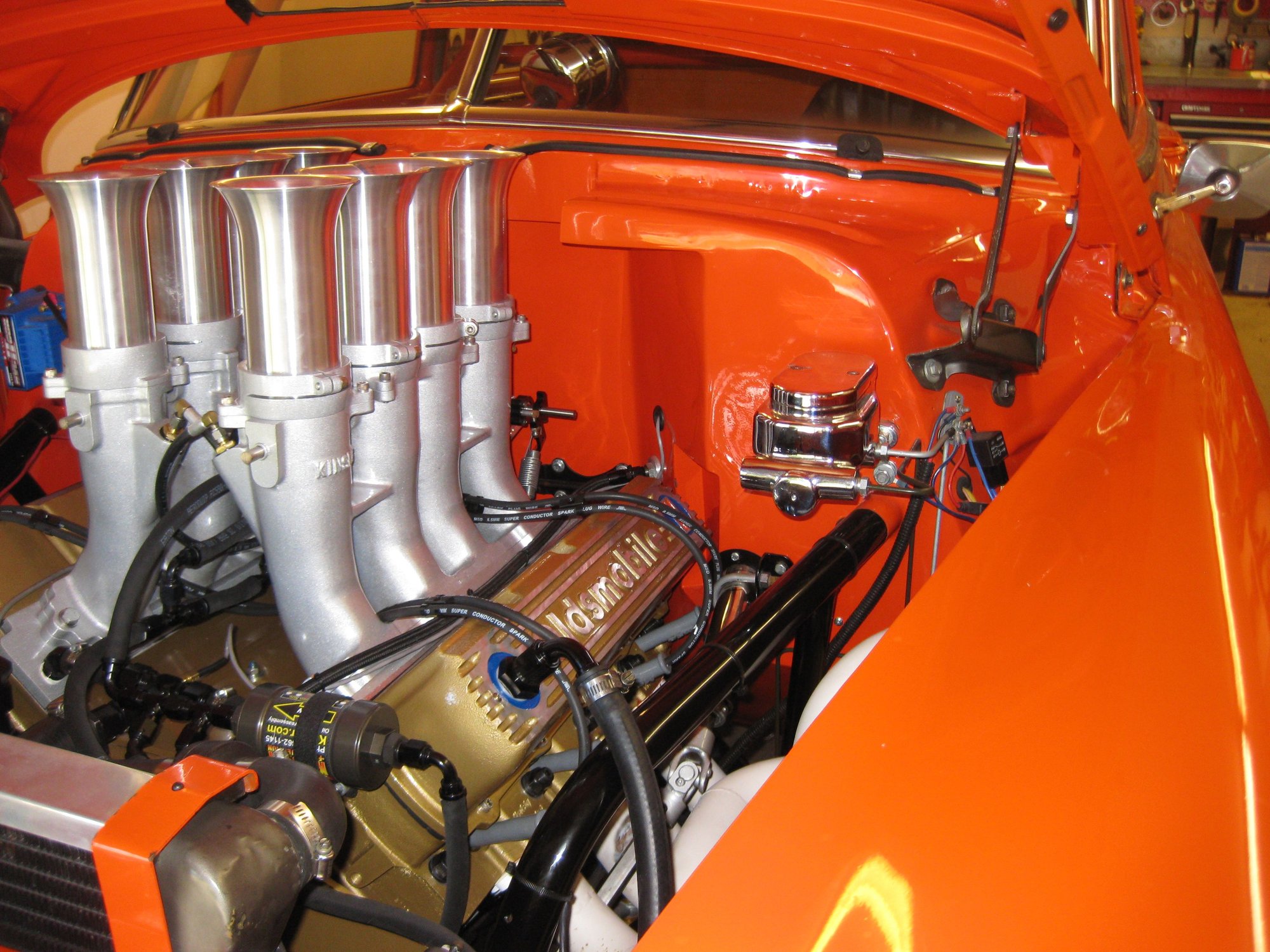

Rocket block and heads
4.400 bore 4.25 stroke 517"
15:1 compression
Kinsler mechanical injection on methanol
Block bored and lifter bores resized for .904 lifters by BTR
Have since changed to a Moroso alum oil pan
Only got motor running late September so not too many passes, best so far 9.27@142
15:1 compression
Top shelf gasser build very cool!
Thanks for sharing
