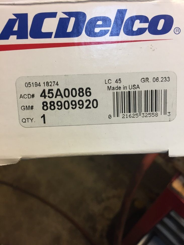

I may never learn. Ordered tie rods from RA, low a behold... they're the wrong ones. Painted them so they wouldn't rust and when I went to install them no bueno. As usual, biggest problem, no number to call so I've no choice but try the email route. Anyone know what part numbers these should be? Anyone know what these fit? Possibly a B body? Advanced didn't have AC Delco and still needed to order the Moog's, so I went with these. looks like I'll be getting the Moog's now.

According to the part number on the box, it's supposed to be for a 72 Chevelle. I know Chevy used different tie rods on 71-72 Chevelle vs the previous years. I thought the only difference was the adjustor sleeve thread size.

For best quality, go to Napa and buy their Napa Chassis tie rods, unless something changed they are still made by Dana/Spicer here in USA. AC Delco and Moog are made overseas.

The box would beg to differ.

How about we start from the beginning.
Are the disc brakes (and steering arms) original to the car or not? If not, where did they come from? The 1970-earlier arms (and matching outer tie rod ends) have different part numbers from the 71-72 arms and tie rod ends.
The correct 71-72 steering arms are P/N 408604/408605. These steering arms use outer tie rod ends 7810072. The 64-70 steering arms use outer tie rod end 5678805.
I'll add that 88909920 crosses to 7810072. This is also Moog ES406R.
If you need the early one, it's Moog ES333, which also crosses to P/N 88909871.

Old stock most likely. I would save that box, flatten it and frame it, you know in memory of good ol days. LOL.

Ok, So I did as Joe suggested and torqued them down. Everything worked out. Apologies to Rock Auto. Thank you to all. Hopefully I'll have everything back together soon as all the parts are in. 70Cutty if you want I can send you the boxes. Believe me, I was ecstatic to see the "MADE IN U.S.A" mark on them. The second picture is something you see less and less of.
Torqued to 35lbs.
We won't be seeing this any more.
