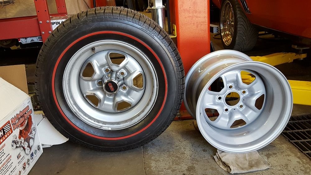

Two other positives came out of the trip. The shop that is doing a majority of the work on my Cutlass committed to the car being ready mid to late July ( code for probably early August). I also got the hard numbers used for the backspacing on my rims. The backspacing is 5.3". After talking to the shop owner it sounds like we had room for 5.5" which likely would have reduced the amount of rolling that we have to do on the fender well lip. The shop also had a very custom Mustang ( 68 / 69 vintage) that was on the hoist being worked on. It was very well done underneath but I never got to see the interior which I was told was even better finished! The funny part is that the car was bought at Barrett Jackson for $200K and probably has more than that spent on it. The custom sub frame additions and suspension would make this car handle better than they ever did from the factory. The only original parts that are actual Mustang is the body shell. Funny thing is the car has a Hillborn FI stack that is not working well and is also running hot ( a Rousch 427 under the hood). You can spend a lot of money and still have issues!

5.3 " backspacing ( stock 7 X 15 converted to 10 X 15 )
7 X 15 vs 10 X 15
