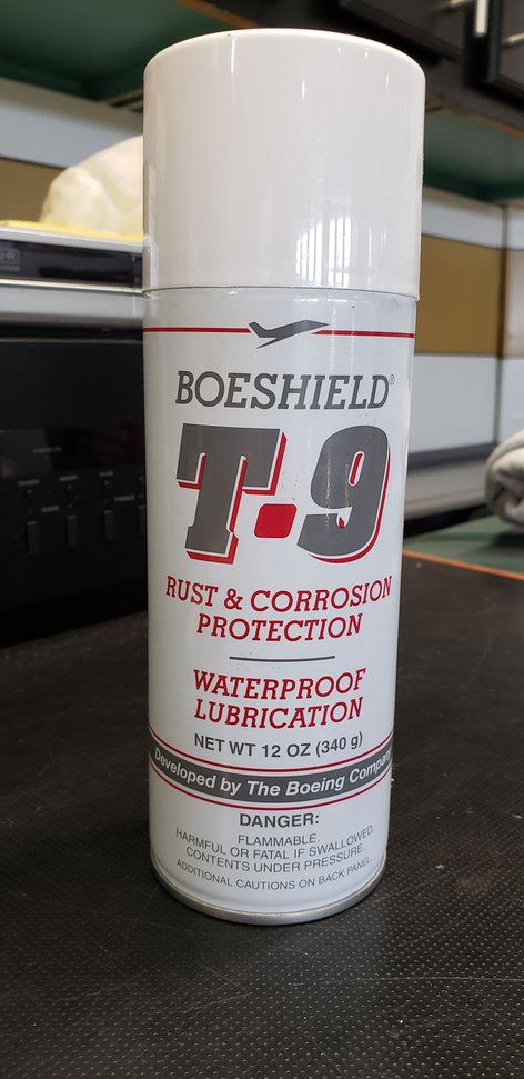

Sunday morning discussion. While working on my 68 Cutlass, anytime I remove a nut, bolt, or fastener, I like to use some degreaser then put them in EvapoRust (best rust remover ever) for 24 hours.
Then I use a Tap or Die to clean up the threads. But the bolts are now clean and are prone to new rust.
What recommendations do you have for coating the parts to prevent future rust?? oil, spray, anti-seize, dip, etc.
I like the look of the cleaned nuts and bolts. they re-install easily after cleaning the threads. But they start showing surface rust in only a few days.

I used this with great results. It goes on wet then dries as a protective film.

What 69 Hurst posted.

I've never seen that. Where does one get it?
Ordered it on Amazon, I think it was about $20 for a 12oz aerosol can.

Thank for all the comments. I will try to Boeshield T-9 to protect the fasteners. Hopefully it will last for a while.
I wanted something to coat bare metal to keep from rusting. I didnt know if there was some kind of spray coating (not paint) that would seal and protect the nuts and bolts.
