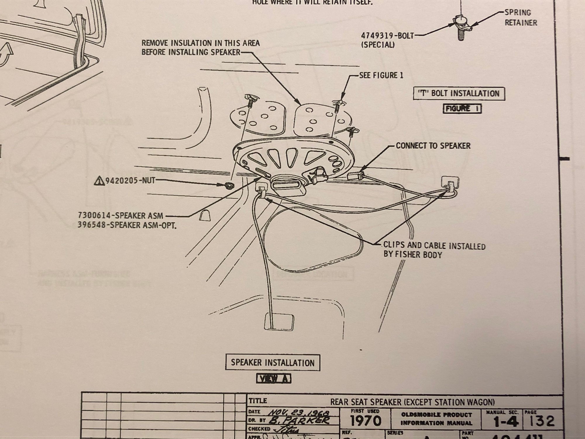

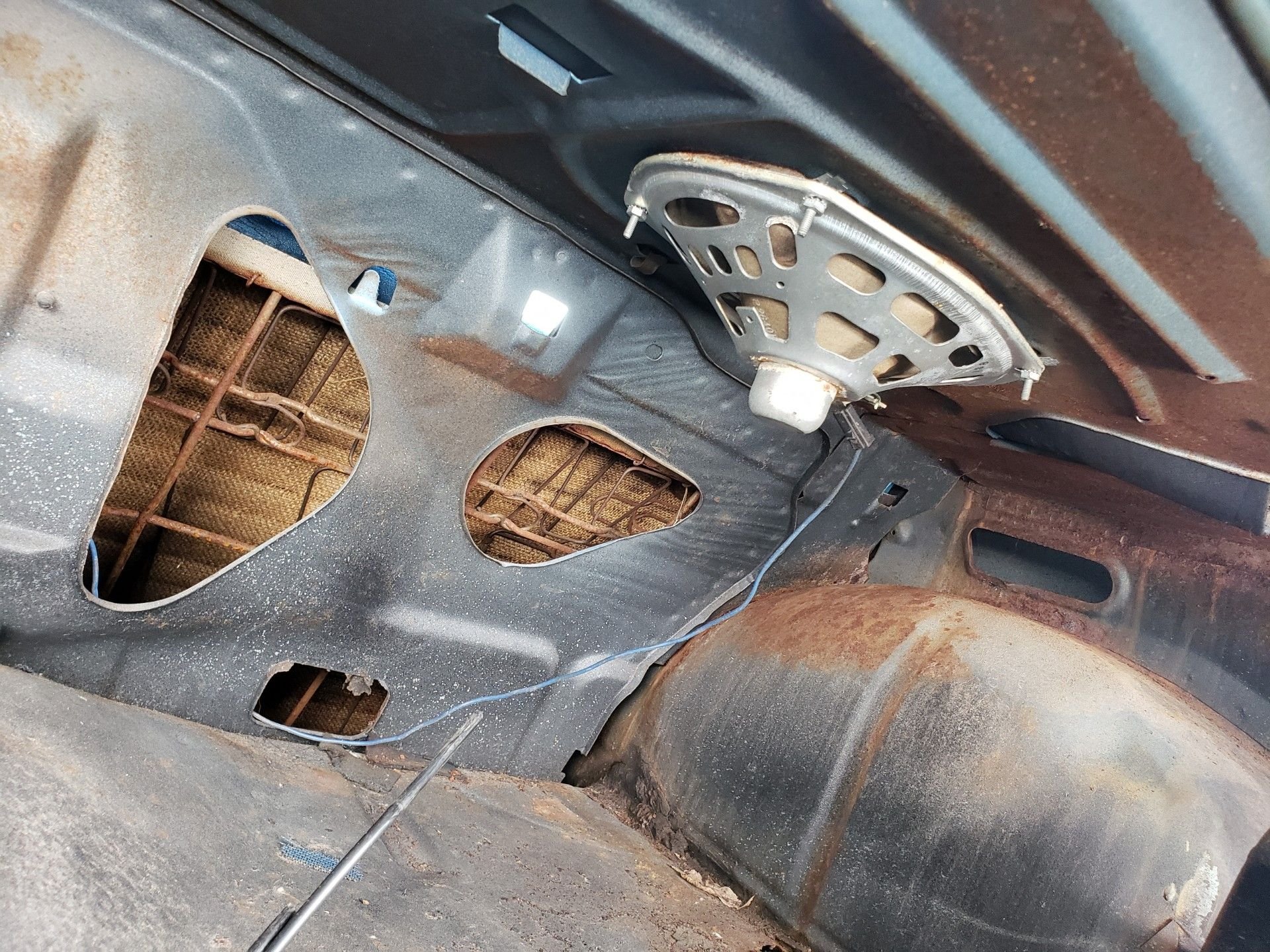

Thank you so much That's a huge help! You wouldn't happen to know which hole it runs through by chance? Thanks again
Old Apr 14, 2020 | 07:18 PM
BSiegPaint's Avatar
Joined: Nov 2017
Posts: 1,527
From: North Royalton, OH
Here is a shot of an original speaker and the ASM page - looks like they followed the directions!
Old Apr 15, 2020 | 02:49 AM
hershillgn's Avatar
Posts: 59
Perfect thanks so much!
