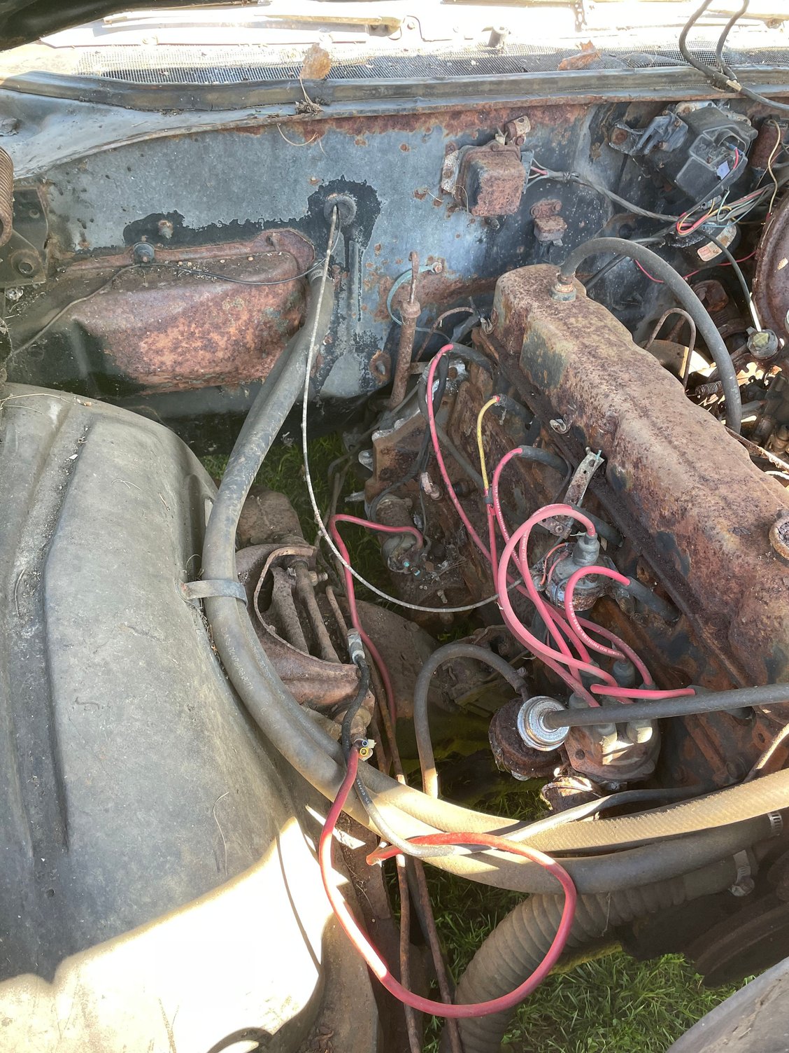

In the engine pic, I see a hose from the valve cover to the brake booster. Strange, don't think there is any vacuum there.
Also, since it is a chebby six, would it have the chebby bolt pattern for the trans?
I don't think the trans of that era had dual pattern trans.

Actually, the ST300 used in the 1966-69 cars with I6 DID have a dual bolt pattern. I'm not sure what's in a 70, however. Here's that Jetaway for kicks.

Good catch on both items.
It looks like the PCV valve is connected to the brake booster; or conversely, the brake booster is connected to the PCV valve. Either way, neither of those system are working correctly as they both need to be connected to a manifold vacuum source.
Since that is a Chevrolet engine, with the engine swap a trans swap or an adapter plate would be needed.

P.S. Secure the positive battery cable. It looks funny going through the A-arm like that.

well it has h.e.i. so either the engine is newer or the dist has been changed.also the single hose heater core is "cool".

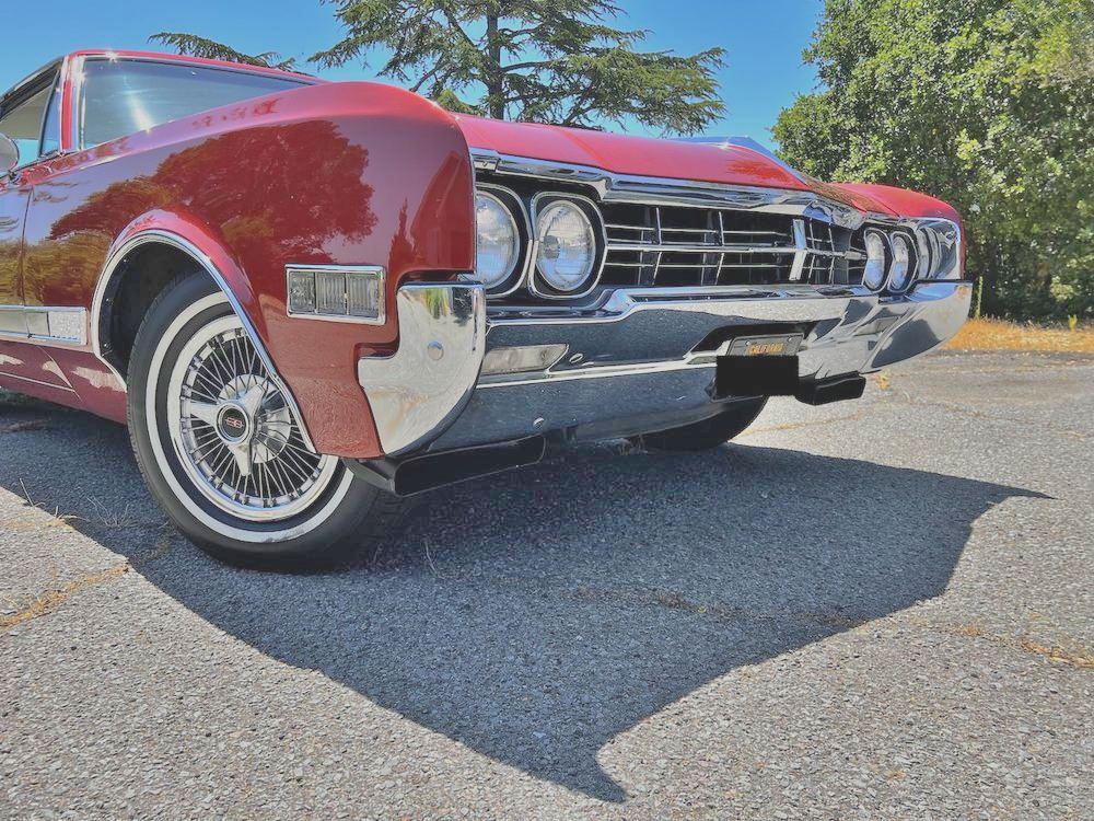

I happened to get my '66 Starfire out of storage this morning. Here's what a an Autumn Bronze '66 Starfire looks like with OAI hood scoops:
OAI scoops are not factory. They were never offered on a Starfire, but it made for a good covid project.
The Cutlass / 442 under bumper scoops feed 4" diameter plastic hoses which connect to factory looking 4" cloth hoses which go right into a Spectre dual intake air cleaner. The connector between the Spectre (female) inlet and cloth hoses are 2 4" plastic (male/male) downspout connectors notched just a bit to make a tight fit on both sides. I decorated the Spectre chrome air cleaner with Olds Stickers, but I'm not taking the faux-factory any further than that.
Here are a few more shots:

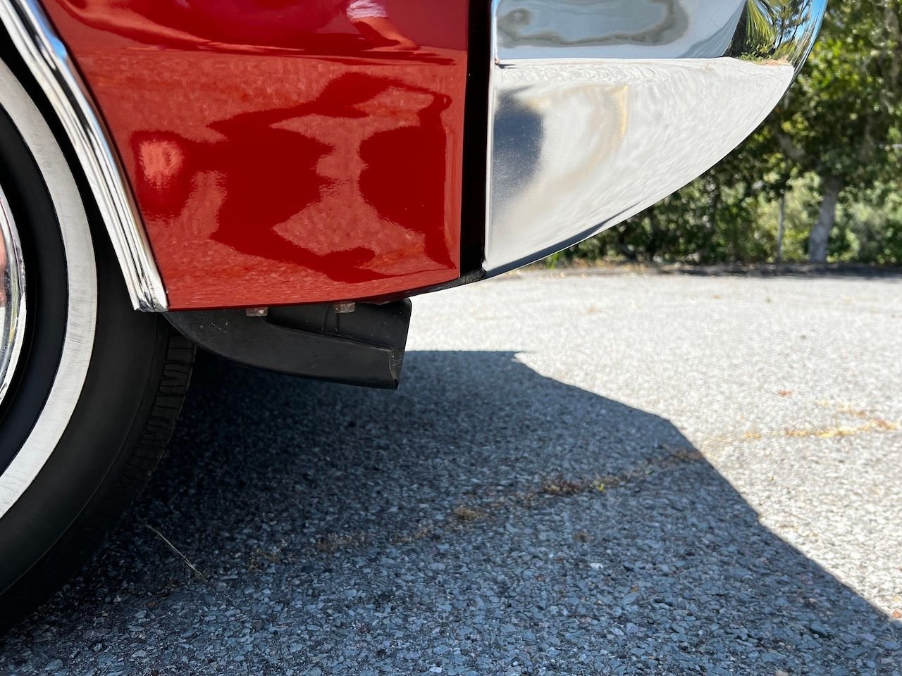

OAI scoops must be forward enough of the front wheel turning radius to not interfere when you turn the wheels. Then drill a giant 4" hole in the front lip of your inner fender. Get it as far forward as you can.
It's a little dark, but zoom in & you'll see the black under bumper scoops. These are reproduction pieces intended for Cutlass / 442's, so I had to fabricate the mounting brackets, which I didn't do all that well.
I needed to relocate the bulb holes for my side lights to allow the intake ducting to clear the lighting fixture rears. Fairly simple matter of a couple of corrrect size holes drilled into the top of the cast-chrome light fixtures. And on the driver's side the ducting is very snug agains the battery. Very snug. Like I had to re-orient my + cable a bit inboard instead of straight back.
