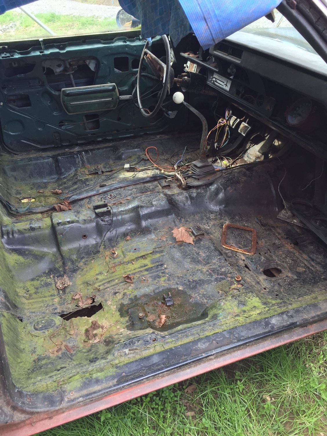

Can someone please tell me if this is a real 4 speed car? I have a chance to buy this 1970 442 convertible. It is a real 44 vin car with factory air. How rare would is this car? 455 in it not sure if # match. Thanks in advance.

2933 total production for the 442 convertible in 1970.
That is not a factory shifter and the trans tunnel does not look correct for a factory 4 speed. I think they made an aftermarket automatic shifter like that back in the day.

Was there that much of a gap between the brake and gas pedals on the 4 speeds? That seems large to me.

GTO pedal pads and chrome
67 ish shifter or 68-72 skylark shifter hard to tell..but looks like 442 to me on the handle..but if it says hurst its a really hard shifter to get
68 chevelle boot bezel laying on floor
looks like a 70ish camaro shift boot or maybe 68-72 chevelle no console
column is busted out
it looks like a pieced together car to me..but that pic is so bad its hard to tell details

You beat me to the Pontiac pedals. It also had a power driver bucket seat & I see the safety sentinel speedo laying in the glove box. Also a power lock & window car. Probably had more options too.

is that a cruise button on the dash also by the wiper ?
I can barely see the top of the 4 on the 442 shifter ....
definetly 67 68 69 style shifter ....
and the optional 1973 bathroom lenoleum flooring pattern headliner....
cant believe you guys missed that option ... https://classicoldsmobile.com/forums...ilies/wink.gif
time to do some rust repair ....
x3 on the GTO pedals ... I would like to see the bellcrank/zbar on that ....
nice catch on the speed minder .... that passenger side option is rare ...

Nicely done people. Is that bracket between the seats indicative of a console car?

yes

Was a power bucket seat car. Seats in barn when barn caught fire�� Very rough car. Has old w27 rear cover. Not sure what to make of it running 455,fake 4 speed. Air convertible has w-30 badges. Sitting 20 years outside.

The car also has electric seat back releases. See relay on the drivers side floor, seems like a well optioned car.
A good indicator might be a close look at where the shifter comes through the tunnel. Does it look like the factory did it or is it a hack job?

From what I hear, the factory job WAS a hack job. A later installation might be neater.

Missing the shifter porch.
Handle is incorrect for a console car.
Pontiac pedals.

I think that is the convertible top switch.

I've been fooled by the old transmission swap before myself. At least yours has the console bracket.

Look under dash above clutch pedal and see if their is a purple wire running to a switch attached to clutch pedal, If so I'd say its factory.

Here's a pic of a factory 4 speed hump/ cutout 70-72.

Factory hole for a 1970 442
The factory hacked the hole in the floor, then added the porch.

Thanks for all of the replies. Here is another pic the current owner send. Is this a factory 4 speed car?

No.

Nope
