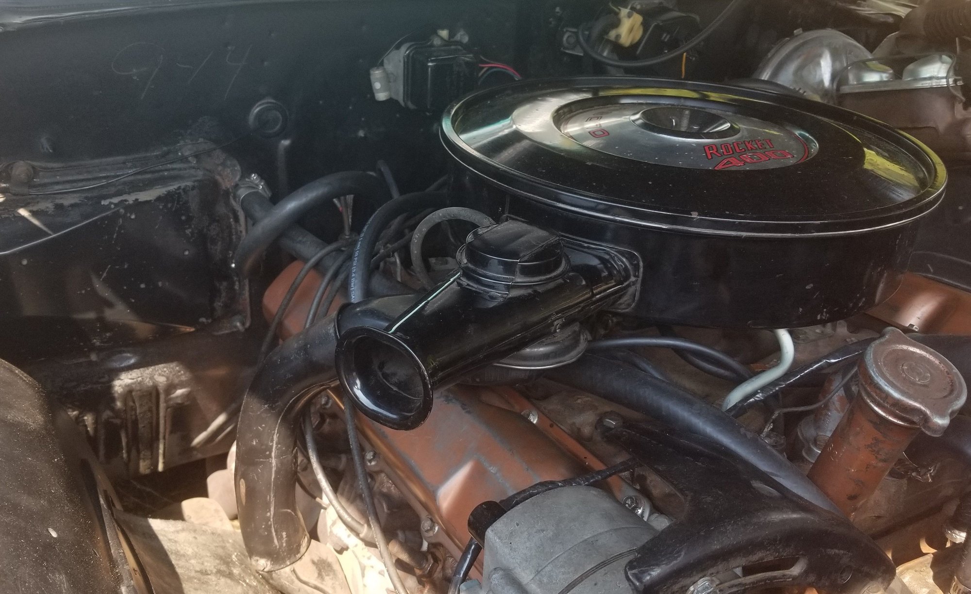

Interior number on firewall after scrub. Except for 4core upgrade from broken 3core, leaving engine area alone.
Thank You all
