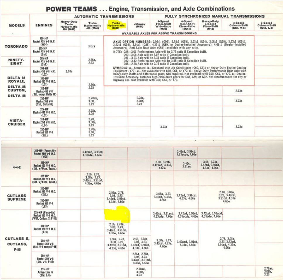

Yes, even the Salesman guide had conflicting info:
M38 listed as a transmission option for the W-31 option
Yet the Power teams chart doesn't show it as available.

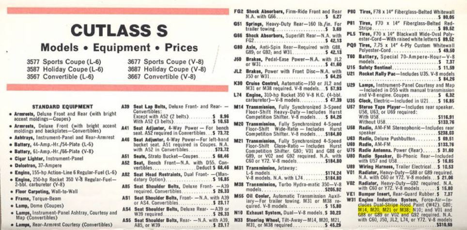

I'll have to correct myself here. The 1969 PIM shows the JO code TH350 for W31 use. The 1969 SPECS booklet doesn't show it, but the trans application page from the PIM shows that W31 application was added on 9-19-68, so Olds had planned on using it when the TH350 finally became available midyear.
Joe P, thank you. I was doubting my memory a little. My wife (deceased) and another young lady who also loved drag racing, were allowed to "order" a car for the showroom floor that would attract young buyers. They picked a Black W-31 with Gold stripes and black interior. The only stipulation was "automatic transmission". This happened at Tate Cadillac-Olds in the spring of 1969.

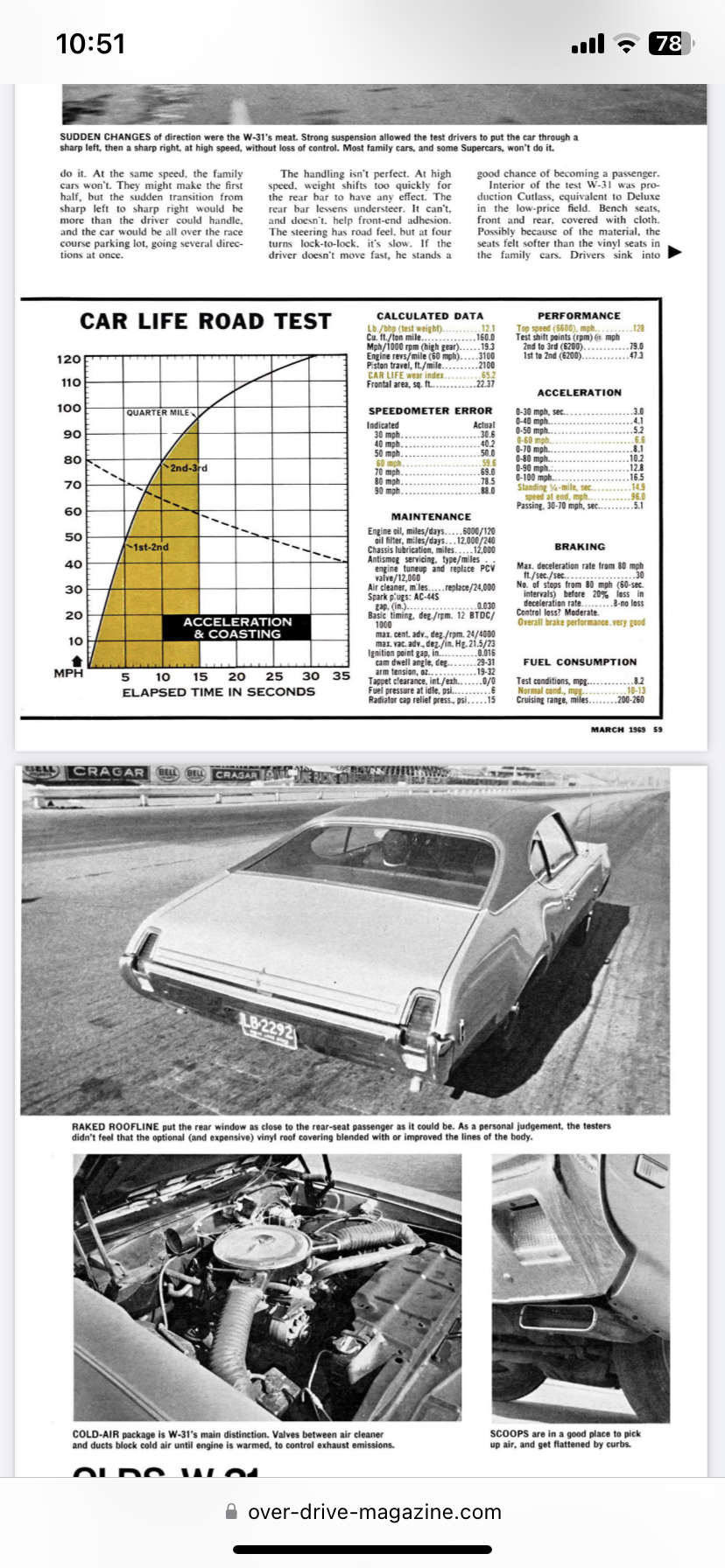

1969 Car life road test of automatic W31. Note the as tested weight of 3935 lbs. that’s with two people. Let’s say subtract 200 for the passenger we get 3735

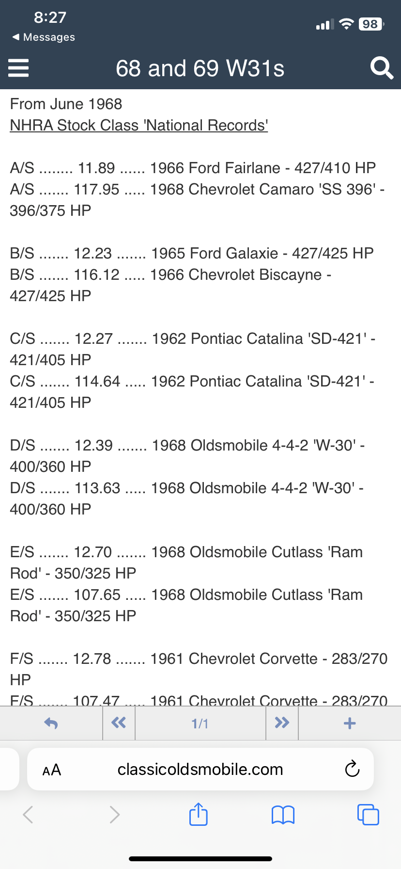

Woodland/Anderson held the NHRA record for a period of time which was 12.20’s Pete Kost in a 69 W30 convertible also held a class record at 12.4
in June of 68 two different W30’s held the class record in D/S and D/SA
the 400G that you proclaim was uncompetitive and sucked..was a feared combination back then..that’s my narrative…truth and facts.

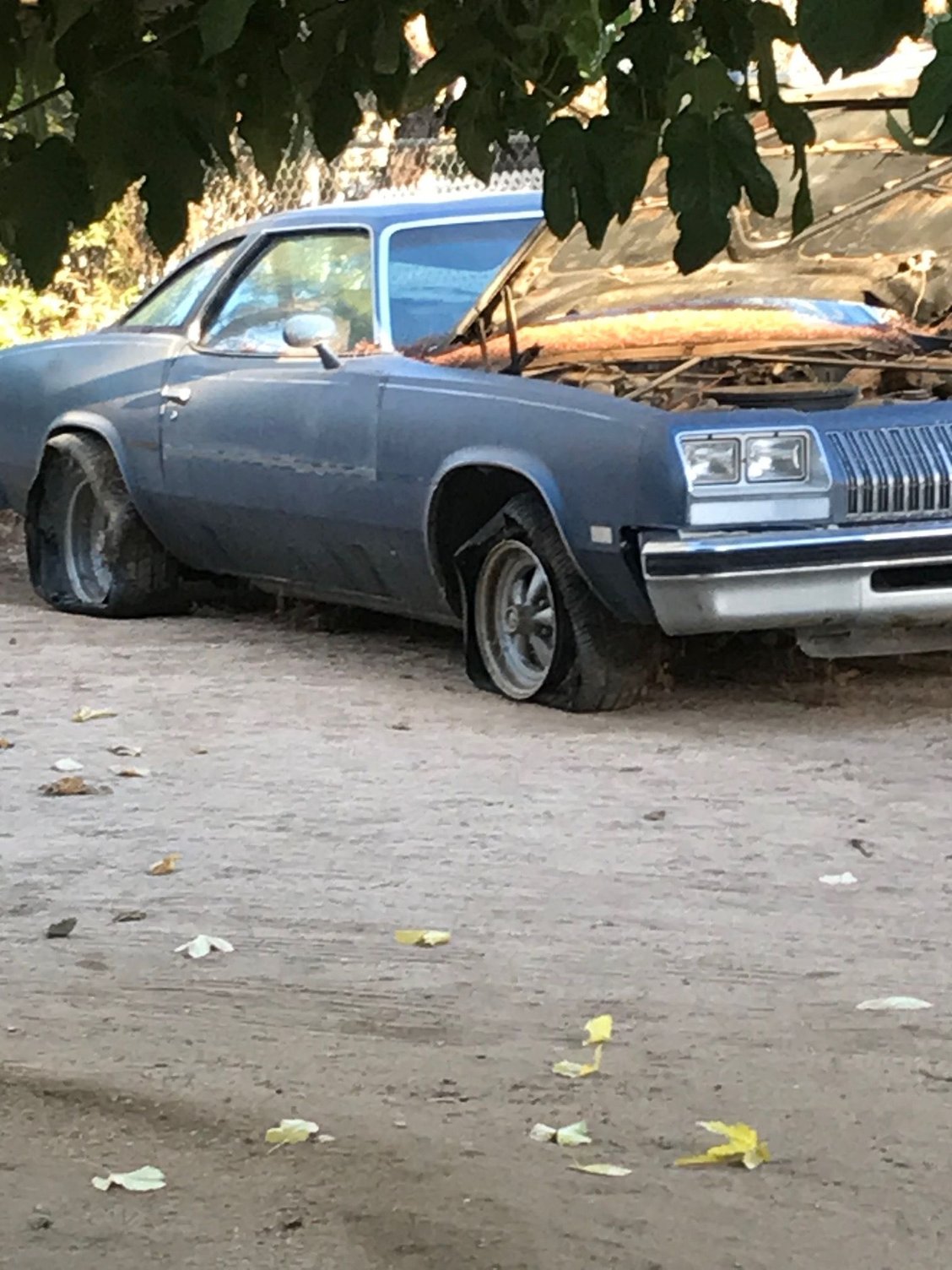

Hi guys, I'm new here. I want to build a Ram Rod 350 clone. I have a 1976 350 Cutlass S engine. Are the crank and rods the same? I read the post and of course the pistons, heads, intake, and balancer are different but I want to get close. Possible with this engine??
Any inputs please.

The crank is weaker but should be fine, especially behind an automatic with reasonable stall. The rods are basically the same. You can use flat top pistons but your #8 heads have about 10cc bigger chambers and need a bowl cutter under the valves to flow as well. You will be around 9 to 1 compression, not the 10+ to 1 the W31 had. You also want headers, the first thing swapped would be the poor flowing log factory exhaust manifolds.
