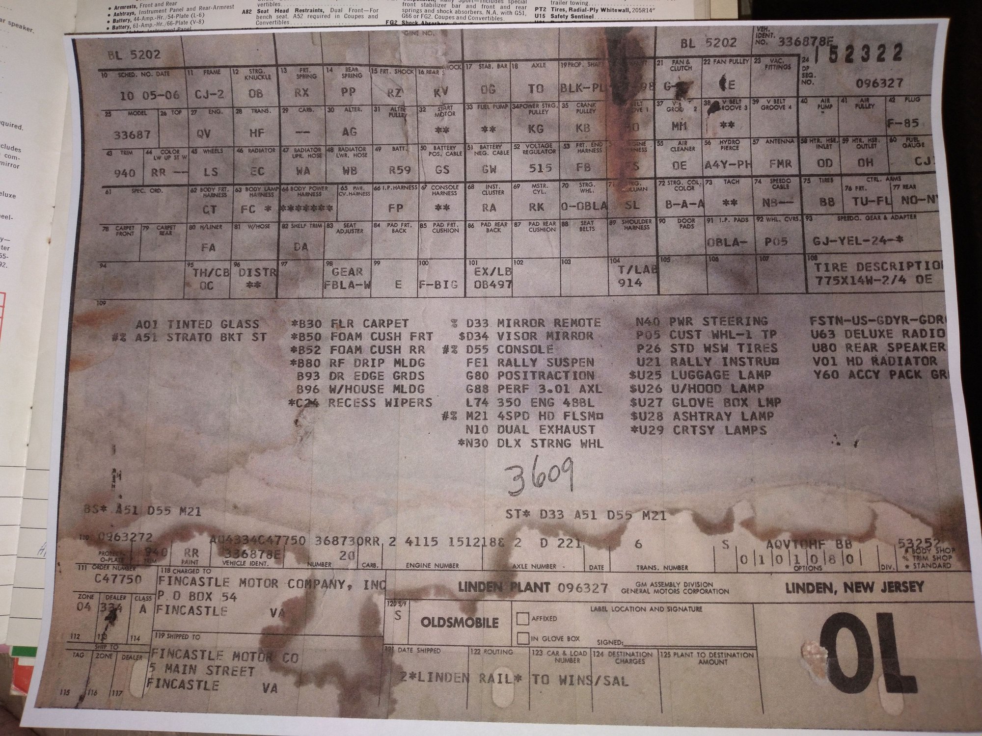

Can some one help figure my 68 Cutlass build sheet? Looks like ram rod,but think it's just regular Cutlass optioned like a ram rod. Thanks

What do you mean by....."optioned like a ram rod" ?
Since its my belief that all "W cars" were built in Lansing (Michigan). Yours coming from Linden (New Jersey) would mean its not a "Ram Rod".
Old Aug 16, 2023 | 01:11 PM
Posts: 15,409
Well that is odd. I have never heard of a 3.01 axle ratio, and certainly never heard that called a "Performance" ratio.

Yes, I have heard that. That's why I say optioned similar to a ram rod. Someone posted a bulletin on the options a ram rod must have and not have. This car has the required options for the ram rod that I can see. That's why I ask. Has anybody seen a Cutlass optioned like this that wasn't a ram rod?

Car has the to 3.91 posi verified. Typo

Probably a misprint...? 3.91 axle ratio seems more likely. That is a pretty cool options list. It's got all of the performance goodies. How would one decipher a ramrod engine on a buildsheet? @taa442 pictures always make the thread more better...let's see the 68!

A four speed and posi rear w/a 3:91 gears does not make it a ram rod, that was available as an option on just about every Cutlass. Nicely optioned car. As OldsterRalph states, it has to be Lansing built to be a Ram Rod, and it would have opition code W31 on the sheet.

See post #4. I know it's not a w 31 ,that's what makes it a weird car. How many regular Cutlass's has anyone seen optioned like this? That's why I ask for help with de coding. Does someone have something similar? Been to many Olds shows and know many Olds enthusiasts. I've asked them all,but so far haven't found any like this so far. Just curious. Thanks

3.91 is TO stamped on differentil as per build sheet

You have a nicely option Cutlass. Ive seen others done like this, also 70-71-72s with the W25 hood. Most Cutlass were ordered as regular family type cars, but some people wanted a 4speed and gear without the wild cam of the W31 motor. If you wanted power brakes, or A/C, you werent getting the W31 motor either

Hey thanks. Yeh, car doesn't have power brakes or ac. It's like you said,it's as though someone wanted all those w 31 options but not the cam. Go figure, if you ordered all the hi po options,why not the engine as well. Maybe cost? Thanks again.

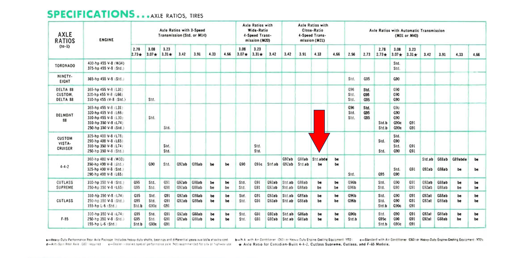

See thread below for reference regarding required options for a 68 ram rod. Bulletin from Oldsmobile.
https://cimg6.ibsrv.net/gimg/classic...4189e8c812.jpg

I thought someone had mentioned that a TO coded 31 spline differential was only available on the w30 w31 cars. Is this true?

Apparently not since your non-W31 Cutlass has one.
From what I recall, in 1968 all of the 3.42 and up ratios in the O-Type rears were Heavy Duty 31 spline axle shafts.

No, it is not true
From the 1968 A-body PIM. The 3.91 axle was available with the M21, the M14 Dearborn three speed manual, and even the M31 Junkaway automatic for both the L74 4bbl and the L65 2bbl motors.

How do you interpret that date code in the upper left corner? This car could have been ordered before the ram rod option was even announced, and someone just wanted a hot rod cutlass....

It's a QV engine code. 350 4 bbl manual trans (not W31). HF is an M21. It's the most lively SBO you could have ordered without it being a W31. What does any of this have to do with a W31?
And TO is a 3:91 so it's a typo. Per the bulletin posted above the recommended rear for an M21 in a Ram Rod was 4:33
And FWIW this car is optioned with FE1 suspension which wasn't a mandatory option with the Ram Rod (but should have been)

The build sheet shows RPO G88, which also designates 3.91 gears.
Interestingly on the 1968-69 cars, the 4.33 axle was actually standard equipment in the W30 and W31 with manual trans (note that the Ram Rod doesn't show up in this edition of the SPECS booklet).
