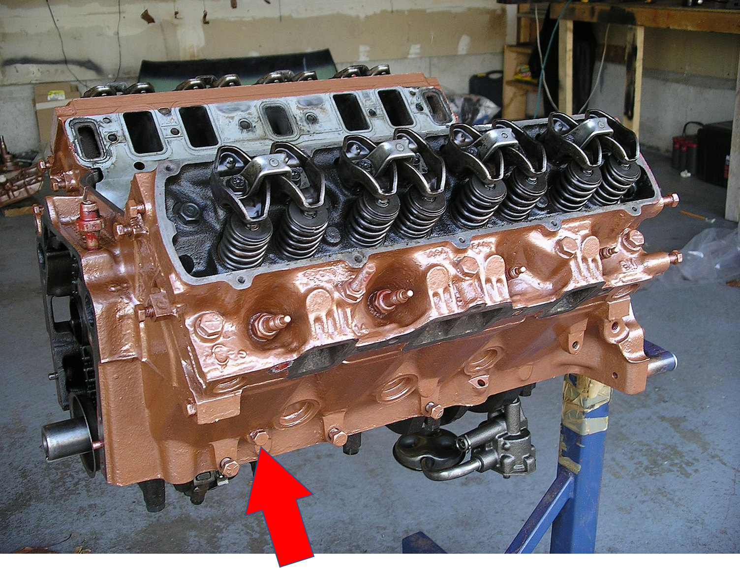

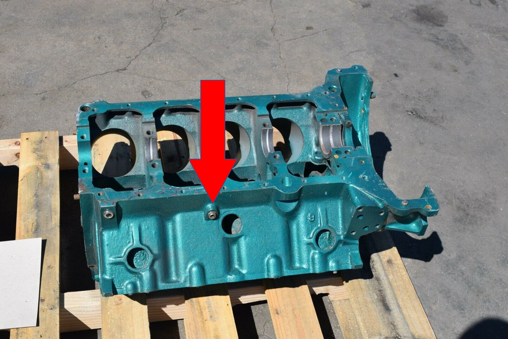

There are pipe plugs on each side of the block for draining the cooling jacket.

Thanks for the picture. Aside from being hard to get to without a lift, I’d be a little worried that they would begin to leak when they’re put back in. I’m going to stick with the drain, fill, run, fill, etc. I’m on the fourth time now. Still pretty green.
Actually, I missed the fact that you're asking about a 1955. My first photo was a second-gen block. Here's a first gen Olds V8 block.

Thanks for that. How do you get the arrows into the picture?
