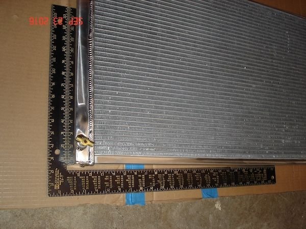

I have a Champion CC161 radiator with dual 13" Derale electric fans and shroud. I had some fit issues with the Champion radiator because the core was not square preventing the shroud from fitting properly. The core measures 28.25"x 17"x 2.25" thick with 3-rows of 5/8" tubes. I don't have many miles on my car since the restoration but engine temps so far have never exceeded 220 degrees in 98-degree weather (running a 180 degree thermostat and no AC).
Here's a pic of the out-of-square core.
