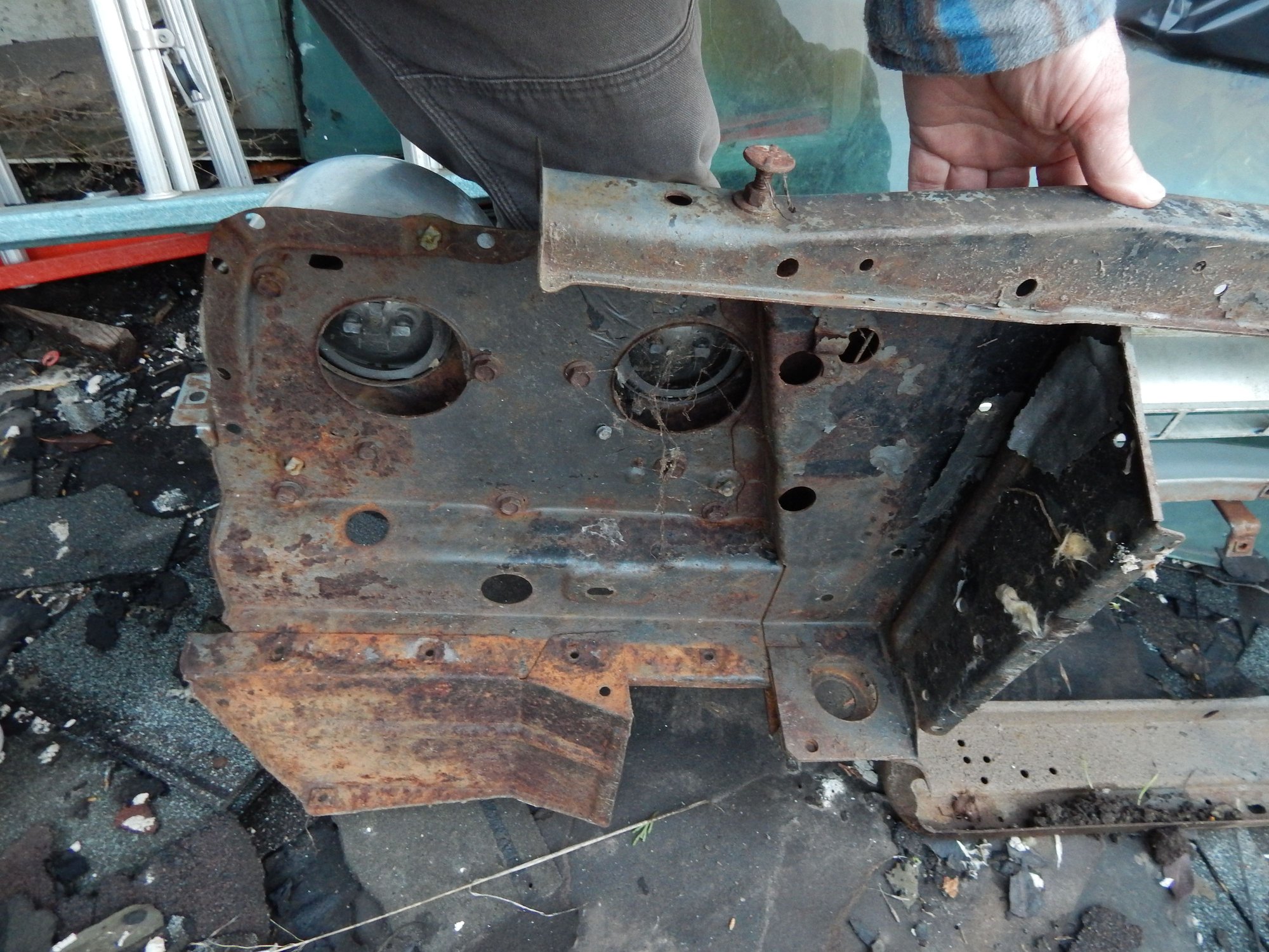

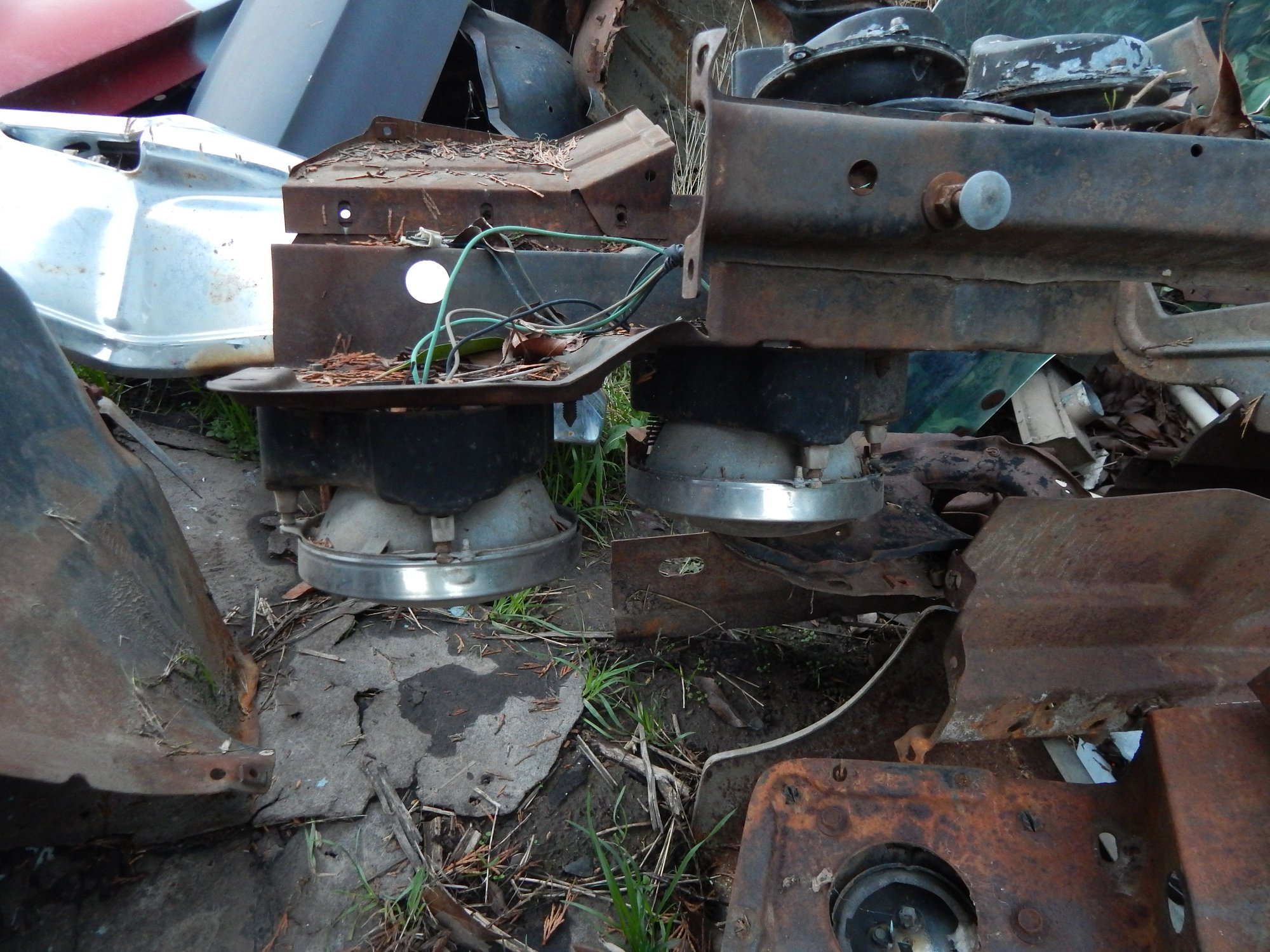

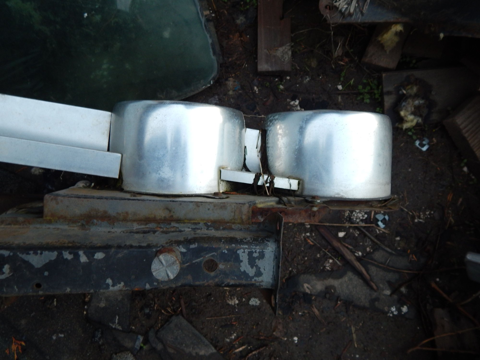

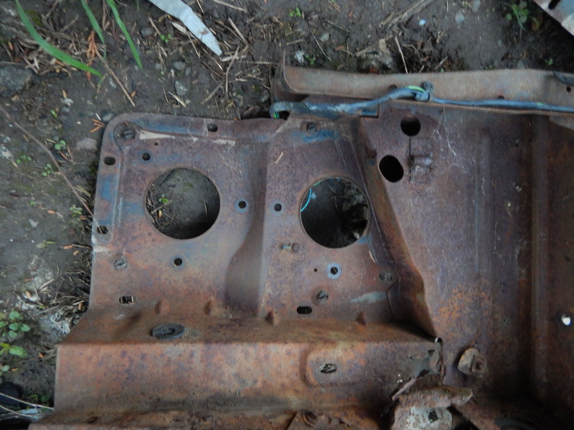

The area in the core support where the headlights attach are different between 1964 and 1965. I looked at this for a guy a couple months ago. Here's a couple pictures of this area.
1964
1965
1965 has the headlights offset, the outer one sticks out further
The 1964 core support this area is flat. The headlights are at the same level.
