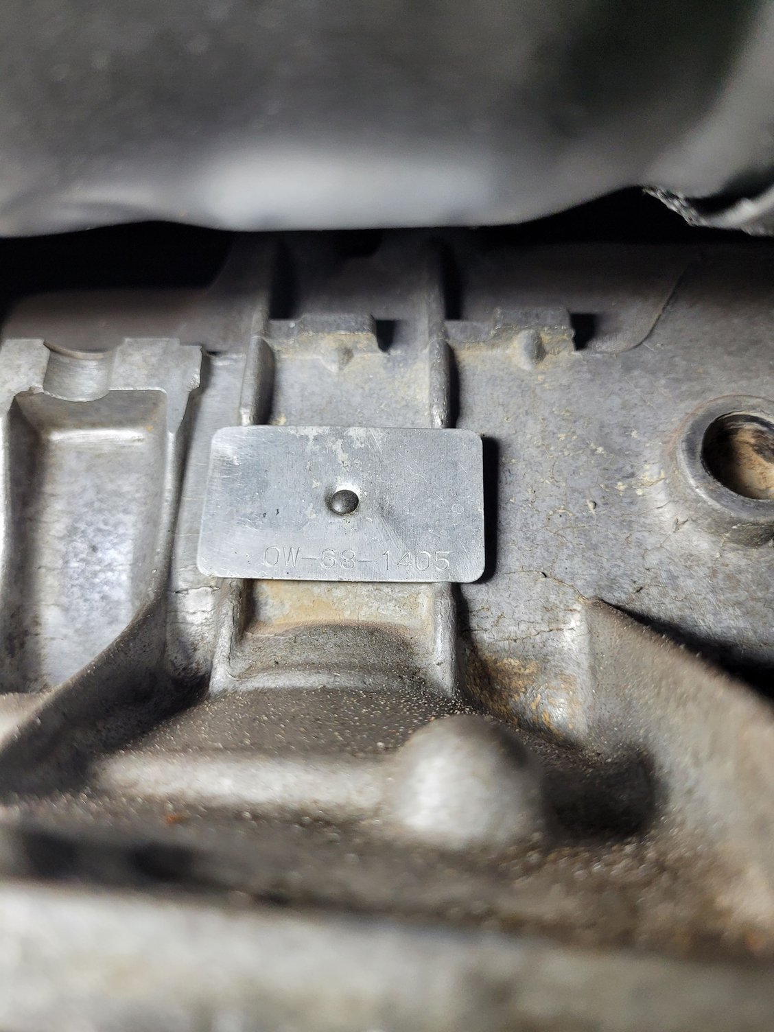

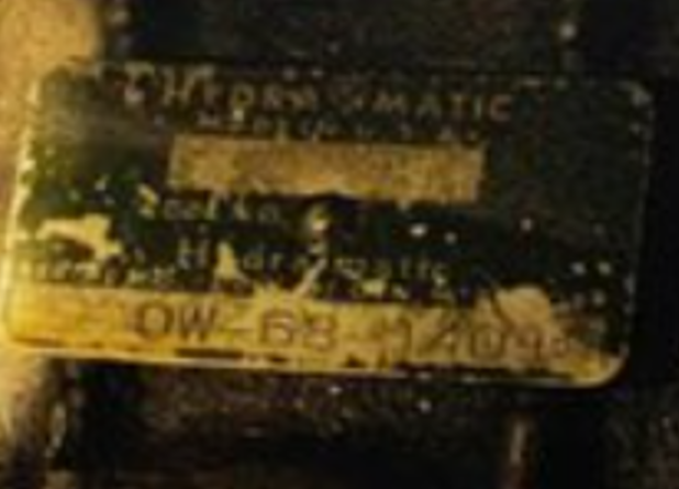

Were the 68 OW transmissions made in batches in reference to the unit numbers engraved on the trans plate? If so is there any documented range of numbers associated with the OW trans manufacturing? I found a car with a VIN 2125 cars apart from mine and the trans unit number was only 4 off each other so that just peaked my curiosity. Thanks

Could you post a photo of the tag?

Unit 1405 and 1409
