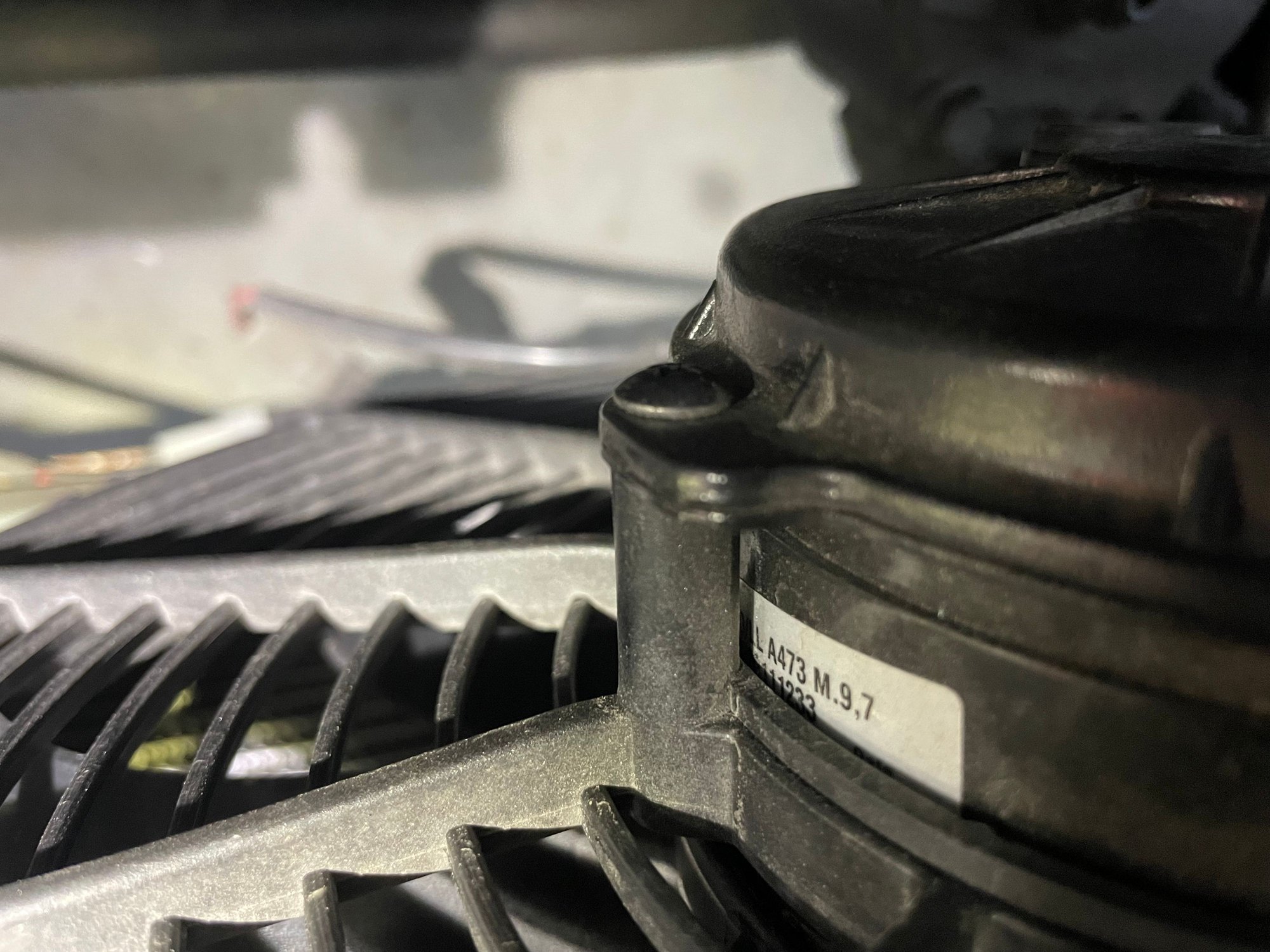

I'm using a stand alone, PWM variable speed, fan controller from AutoCoolGuy.com to control a Derale dual fan shroud. Derale uses proprietary fans from Spal. The controller works well keeping my stroked SBO cool, although, I don't have the AC system charged yet so I can't speak to the performance with the AC on. They don't make the controller that I have anymore, but if you double the full-speed current draw of one fan and add 10% for a buffer then select a controller that will support this load. These controllers switch the ground side of the fan circuit; so you run. a fused +12v directly from the battery for each fan and wire the ground path through the fan controller.
Here's some pics,
Rodney
