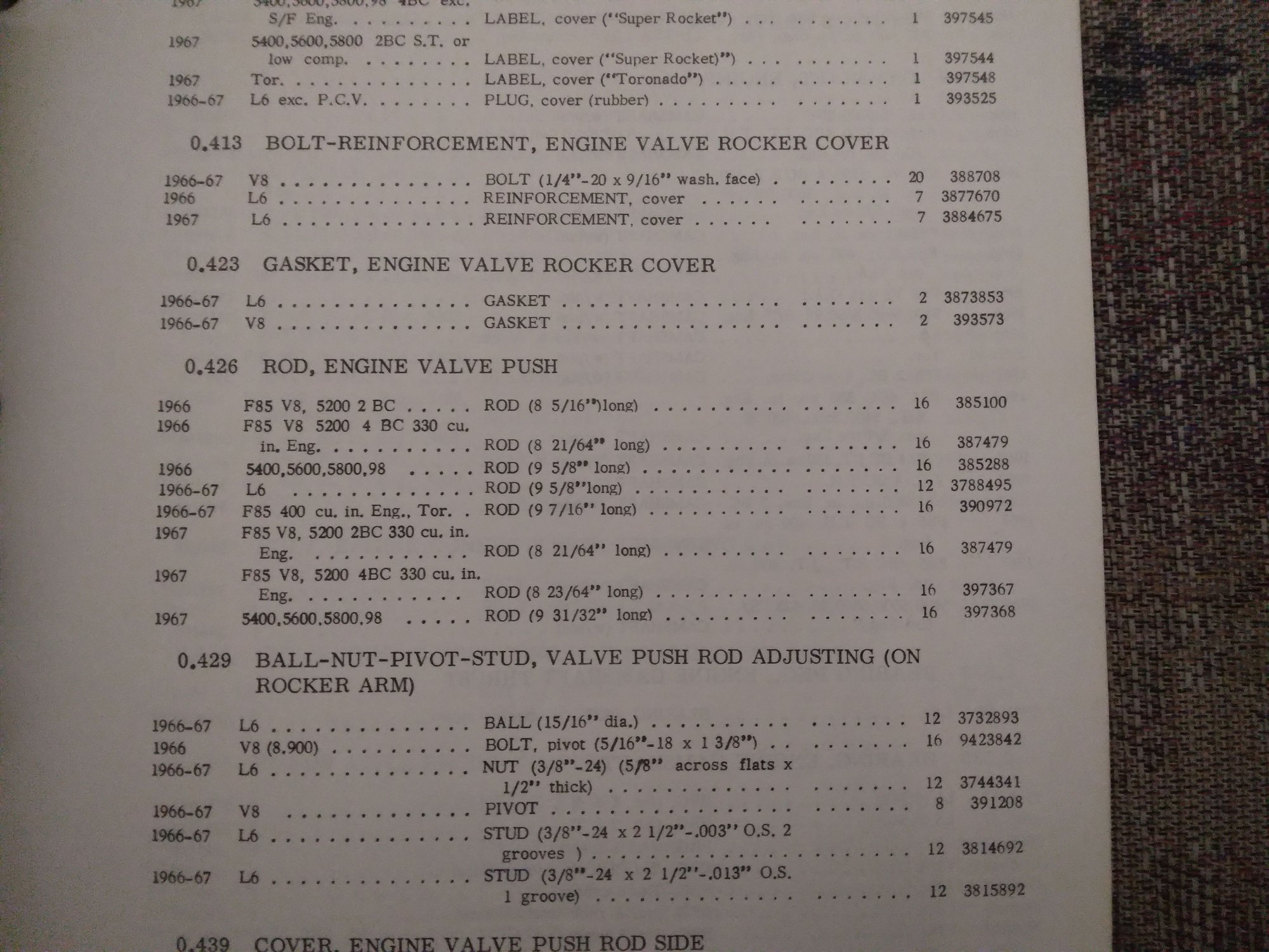

oct 66 parts book list it as 8 21/64
part number 387479
