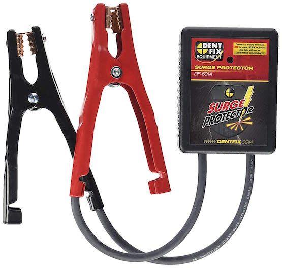

they make a setup that clamps across the battery terminals and protects electronics and such, i always borrow my neighbours when i weld, i dont think they are expensive.
https://www.autoelec.com.au/projecta...protect-car-tr

I took Stan 65 Cutlass' advice and after reading a few welding posts I've decide not to "roll the dice" on this. I ordered a surge protector from Amazon, should be at my front door by Thurs. It connects across the the battery and absorbs any spikes or surges induced by the MIG. There is an air bag sensor within 18" of the weld spot, so I will disconnect and remove that device before striking an arc. Thanks for all the advice and suggestions - I love ClassicOldsmobile.
