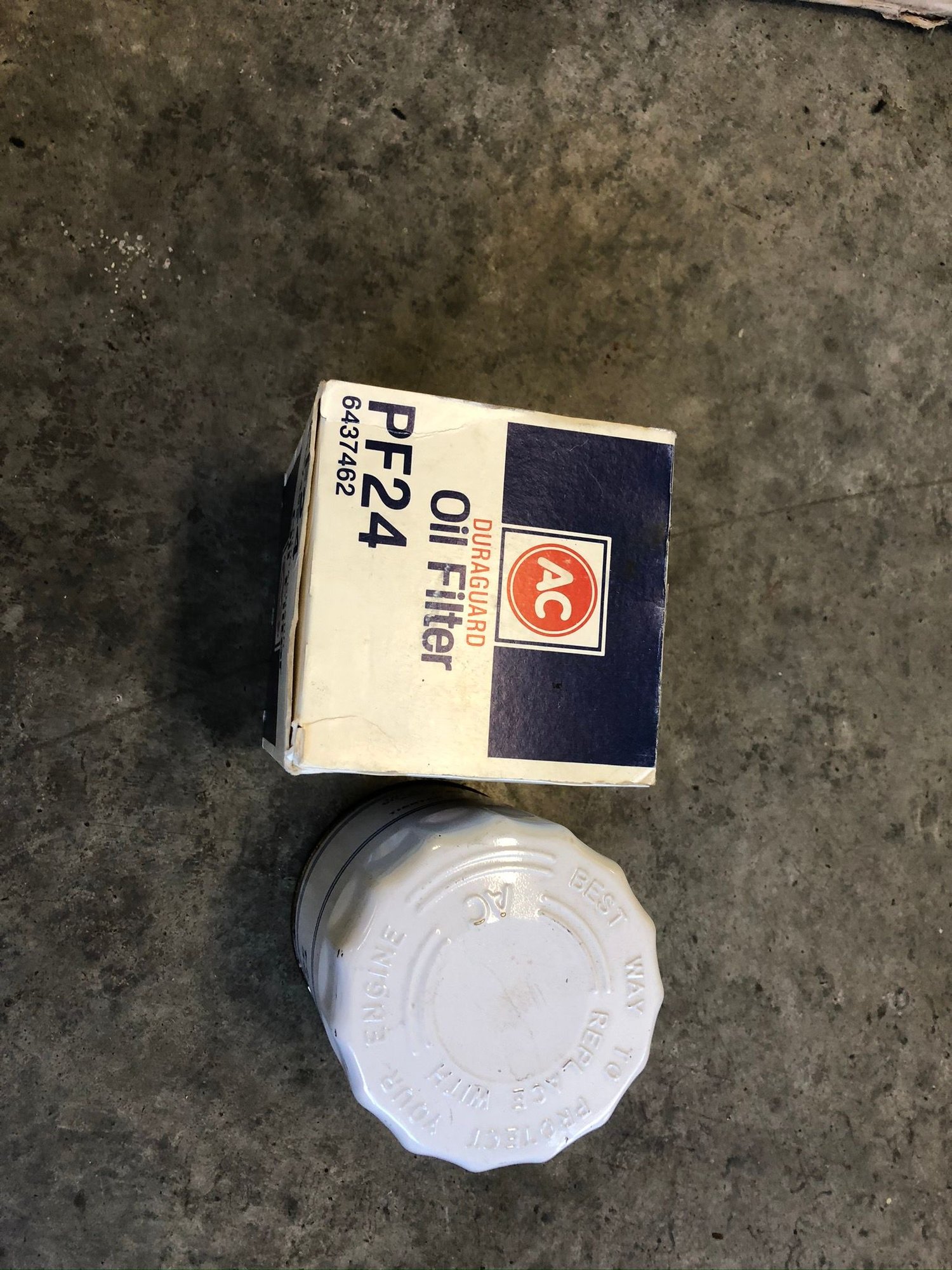

Posts: 2,288
I have had these on the shelf collecting dust forever.

Posts: 15,409
Dang, white and blue with the same part numbers. You're gonna drive some purists nuts with that conflicting information.

Old Nov 20, 2020 | 04:25 AM
Bfg's Avatar
Bfg
Posts: 2,288
I believe the white was earlier than the blue, I’m sure a judge will zing you if it’s the wrong color
