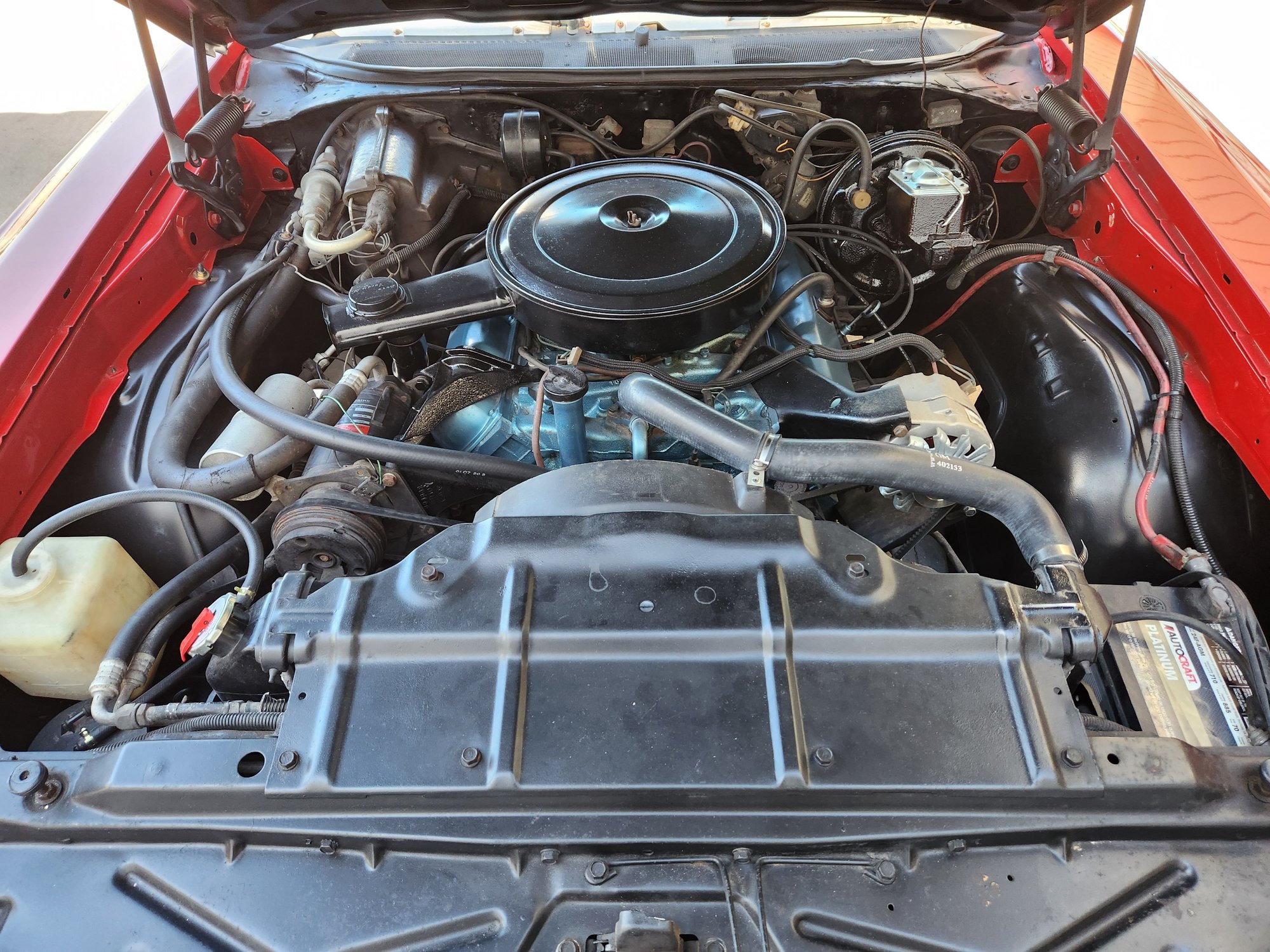

Thank you both for the information. Here is the engine image.
Old Sep 20, 2023 | 07:47 PM
Posts: 12,810
Close enough.
