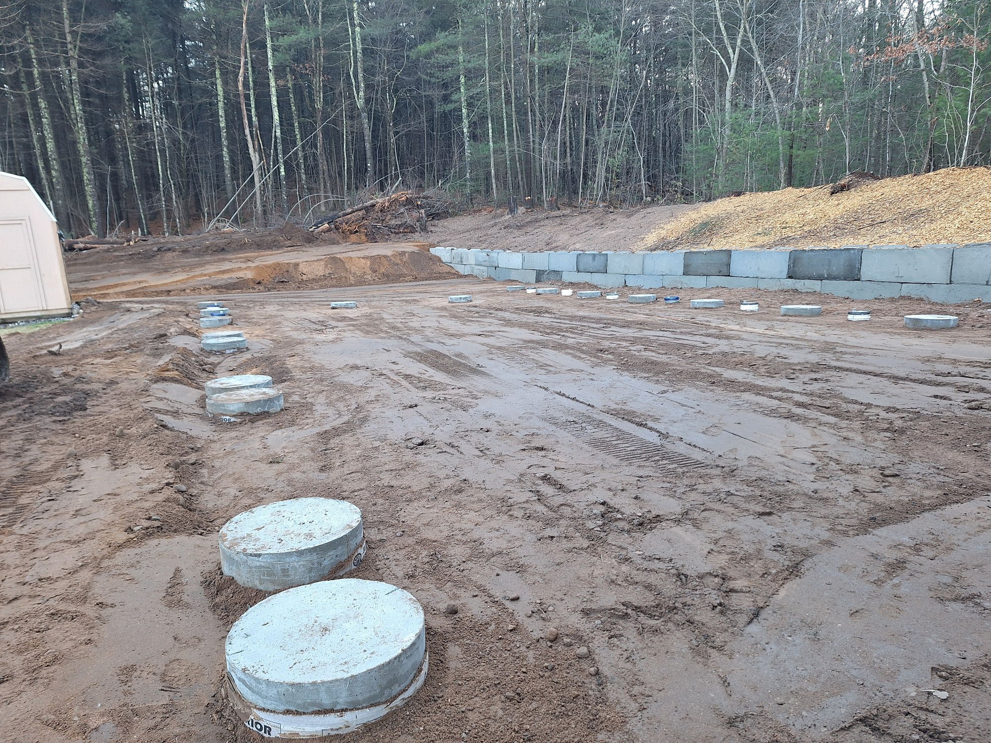

The plot thickens, the state denied my exemption.
I will need some kind of frost protection.
Concrete piers or helical posts.

why are you apposed to a footing and frost wall? That’s pretty much common practice in an environment where the ground freezes. I have a pole barn and the posts have to be embedded at least 48” for that reason (NY). I think CT is 42”
Old Nov 27, 2024 | 04:42 PM
  #65
tkcutlass's Avatar
Joined: Jan 2020
Posts: 1,277
From: CT
I was told by the Metal building people to just pour a slab, the town gave me a permit when the building inspector retired and no inspector was available (they weren't supposed to).
I was under the impression footings and frost walls would be quite costly.
So it comes down to cost, between excavation and concrete I am guessing another 10k or so.
The new inspector suggested an option of helical piers.
https://www.technometalpost.com/en-U...t-connecticut/
I will have to compare the costs, he estimated 200 per pier.
So I am thinking 2-3k.
Yes 42inch frost line

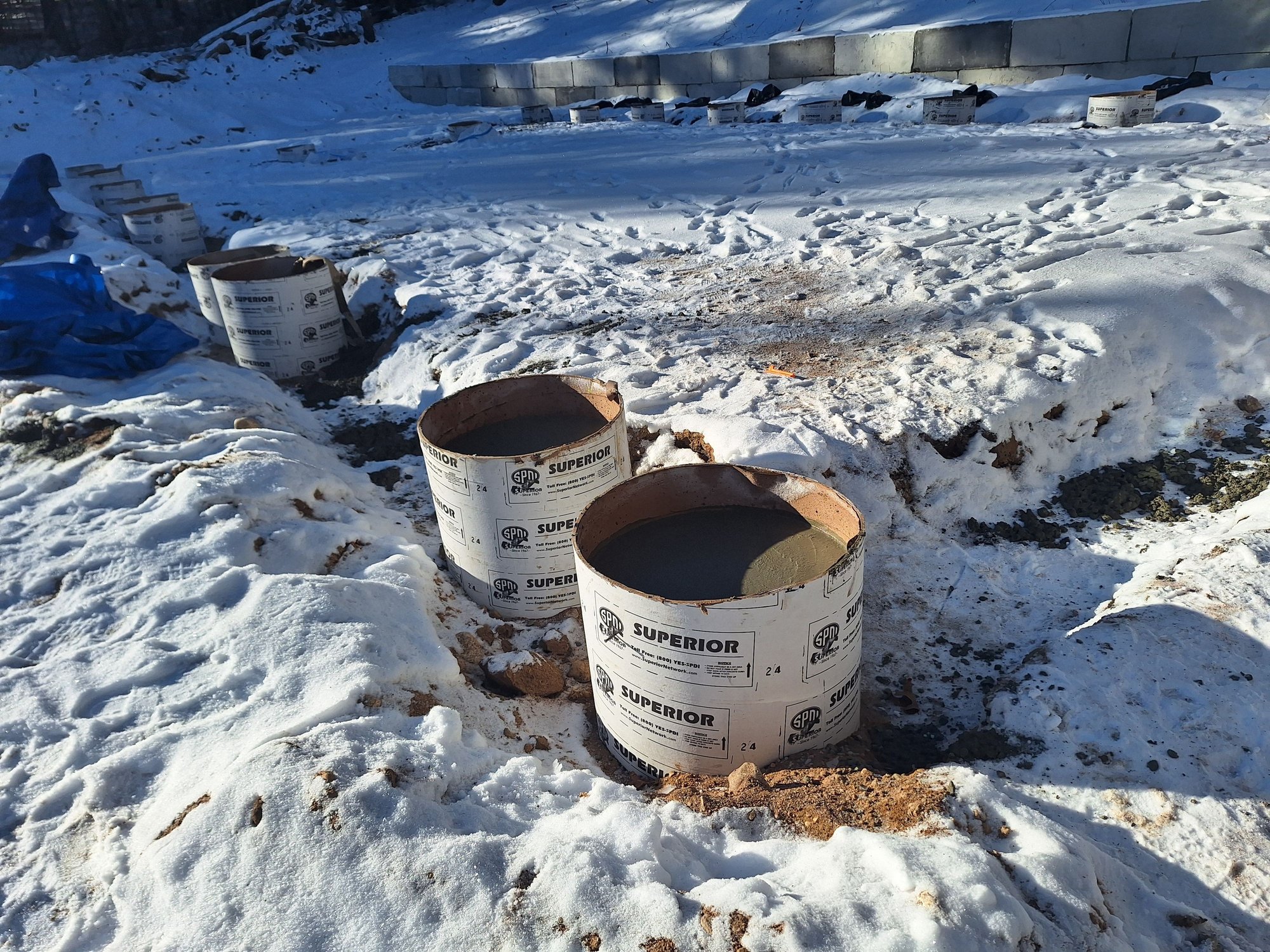

Old Dec 27, 2024 | 03:25 PM

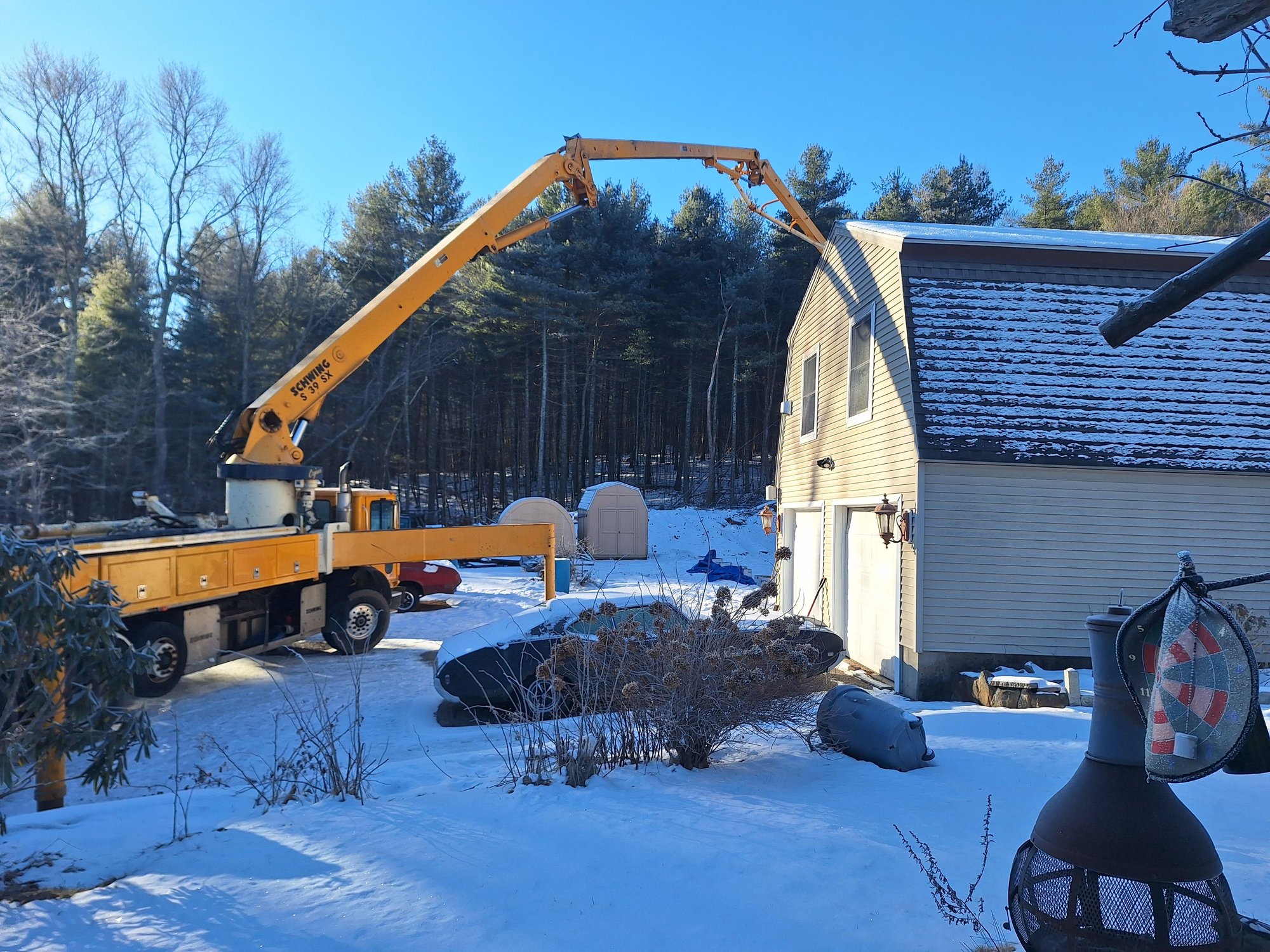

Finally, some progress.
Funny thing the old concrete guy filled the tubes and his 87 yr old father did the finish work. (final height)

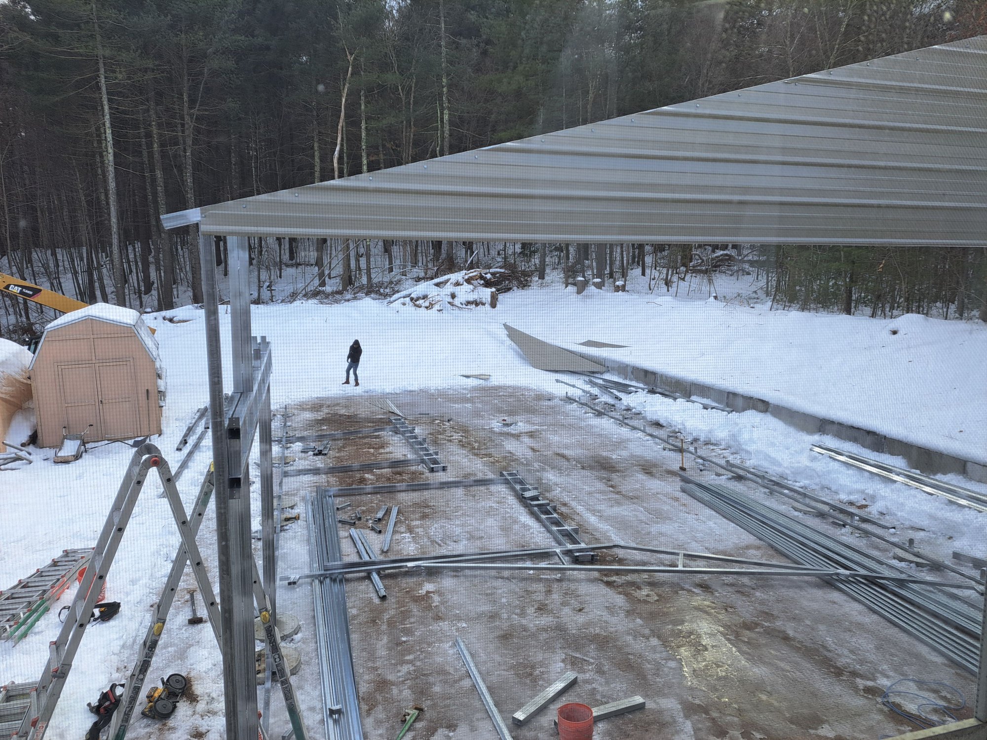

Tentative install date week of 1/27. fingers crossed.
