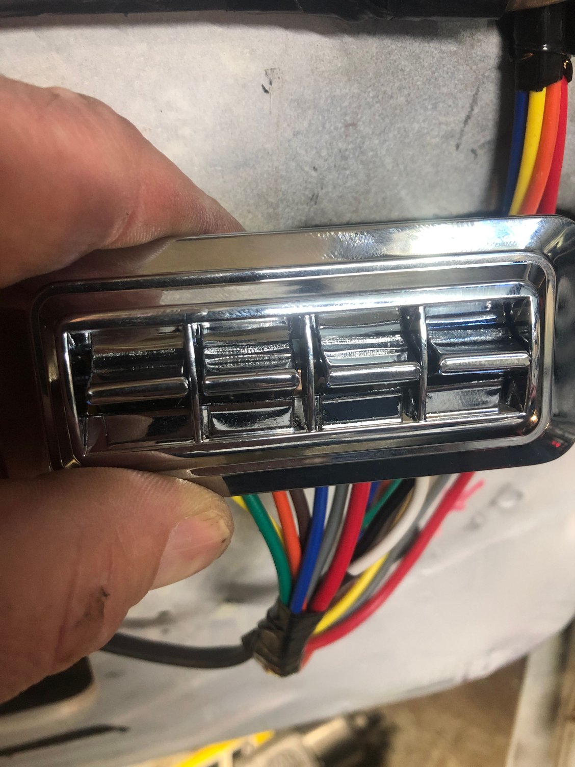

I had assumed the button to the left would be for the drivers door. It’s actually the one farthest to the right. If you flip the switch around, moving the switch up makes the window go down. Is that the way they are supposed to be???

When installed, the driver's window should be the button furthest forward, such that when actuated upward the driver's window goes up. When actuated downward the driver's window goes down. In this orientation, the first two buttons toward the front of the vehicle are the two front door windows. The two rearward buttons control the rear windows. Buttons from front to back are Driver, Front passenger, Left Rear, Right Rear.

Ok, just wondering. I assumed the drivers door window switch would be the one closest to the driver. Thanks

Good point, matt69olds! I thought something didn't sound right so I just now went out and checked my '69 4-4-2 with power windows and its original wire harness and original 4-button switch. The button closest to the driver controls the driver window, the next button forward the passenger door window, the third button forward the driver side rear window, and the 4th button (forward-most button) the passenger rear window. For all buttons, push up to make the window go up and down for the window to go down. Accordingly, I'm pretty sure the driver door window button is the furthest one aft, not forward.

Interesting. I guess I’m not going to worry about repinning the master switch if it’s the way is supposed to be. Just strange that it appears either way is the “correct” way.
I suppose it doesn’t matter, I get use to whatever the switch layout is when it’s all done.

I have a 71 Cutlass with factory P.W and it is set up just like Randy’s 69. Somethings odd about your set up

Things that make you go "hmm...." It could be possible that my door was reassembled incorrectly by the previous owner. Perhaps it was different in 1968 VS 1969 and 1971.
This got me thinking, and I'm pretty sure I got it wrong going from memory - Sorry 'bout that! My car is still on jack-stands and it's been a few years since I last moved the windows up or down. So I dug out the Body Service Manual and checked. Lo and Behold, Randy and BFG's experience matches the drawing in the manual. Either my memory is out of whack - completely possible - or my harness has been altered.

IIRC, it was changed somewhere along the line at the factory.

My ‘71 4-4-2 factory power windows are the same set up as Randy’s and BFG’s, furthest aft is drivers window.

I agree with the multiple replies on the subject. On My 70 SX power windows - the rearmost button is driver door, next one forward is passenger door, next one is driver rear and Forward most button is right rear window. Is it possible you have switch backwards or upside down?

The only way for the switch to be backwards is to push the button down, to make the window go up.
I moved the pins around so it works the way I want it to (button closest to the driver is for the drivers door). To me it seems logical to have the switch closet to me controlling the most used window.

I've had several 4 door GM cars (6 to be exact), late 60's to '88 and all had power windows, all had the drivers window switch closest to the driver, just like oldsconv mentions.
