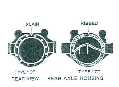

Originally Posted by Tony4-4-2
How do I check?
Look at the rear axle cover - see photo.
Also - the type O vent will be on the axle tube, the type C vent will be on the center casting.
Old Jun 23, 2025 | 02:57 PM
Tony4-4-2's Avatar
Joined: Apr 2025
Posts: 91
From: Long Island NY
Its a type O according to the diagram
