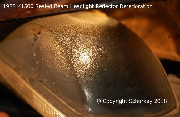

1. It's almost guaranteed that the headlights are NOT receiving the voltage/amperage that they should. Too many years worth of corrosion in the wire harness, and on the contacts for the headlight switch. Headlights should have 12.8--13.2 volts, engine running, alternator charging, headlights (of course) "on". Most old cars are doing good to have 11-something volts. Test voltage AT THE HEADLIGHT, not farther back in the wire harness. Also test the ground side--any voltage on the ground side subtracts from the voltage on the positive or "supply" side. Example: 12 volts on supply, 1.5 volts on ground = 12 - 1.5 = headlights actually powered by 10.5 volts.
2. Headlights are rated for brightness at 12.8 volts, they're rated for service life at 13.2 volts. Less voltage = dimmer, more voltage = burn out quicker. Guys who increase the voltage at the headlights by adding a relay or two, often have the headlights working at 14+ volts, leading to very short service life. Properly done--with a self-resetting circuit breaker on both the low beam and the high beam, and modest-size wiring to keep the voltage in check, this can be a great upgrade. Too many folks use a fuse or two, if there's a problem you're stranded with no lights unless you fix the problem right then and there. At least with self-resetting circuit breakers on high and low, you could just switch from low to high, or high to low, or--worst case--the lights flash allowing you to drive slowly to somewhere safe.
3. Sealed-beam headlights with some years on them are very likely to be dim even at correct voltage. The reflectors degrade, the "mirroring" on the inside of the bulb breaks down, and light leaks out the back side, instead of being reflected to the front. Also, the filament will "splatter" microscopic metallic residue over the reflector so the reflector gets "cloudy" or "dark"; so again less light is reflected out the front where it can do some good.
Here's a photo of a sealed-beam headlight with a degraded reflector. All the light you see on the outside of the bulb is light from the inside of the bulb that's shining through the failed reflector--it's leaking out from the inside.
