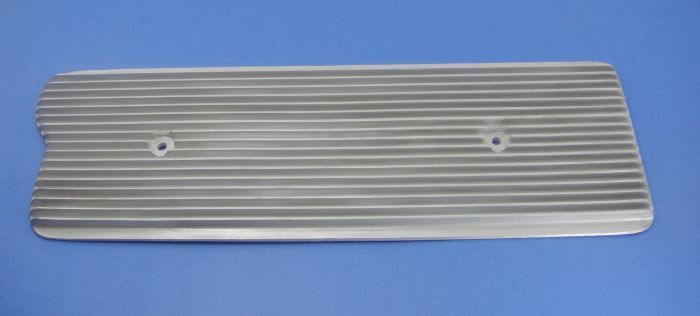

Part Identification Assist Needed
Old Sep 18, 2025 | 05:34 AM
Tri-Carb's Avatar
Joined: Apr 2020
Posts: 1,084
Old Sep 18, 2025 | 05:40 AM
coldwar's Avatar
Posts: 787
From: USA Ohio
Looks like a aftermarket lifter valley cover for 49-64 Oldsmobile. Nice!

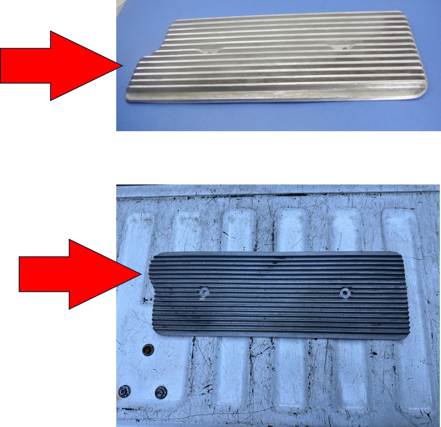

Except that it isn't for an Oldsmobile. Note that the "S" curve to clear the distributor is reversed from that on an Olds motor. Top is a cover for a first gen Rocket V8. Bottom is the OP's cover.

Looks Nailhead to me
Old Sep 18, 2025 | 06:49 AM
Correct.
https://www.obrientruckers.com/valle...-nailhead.html
