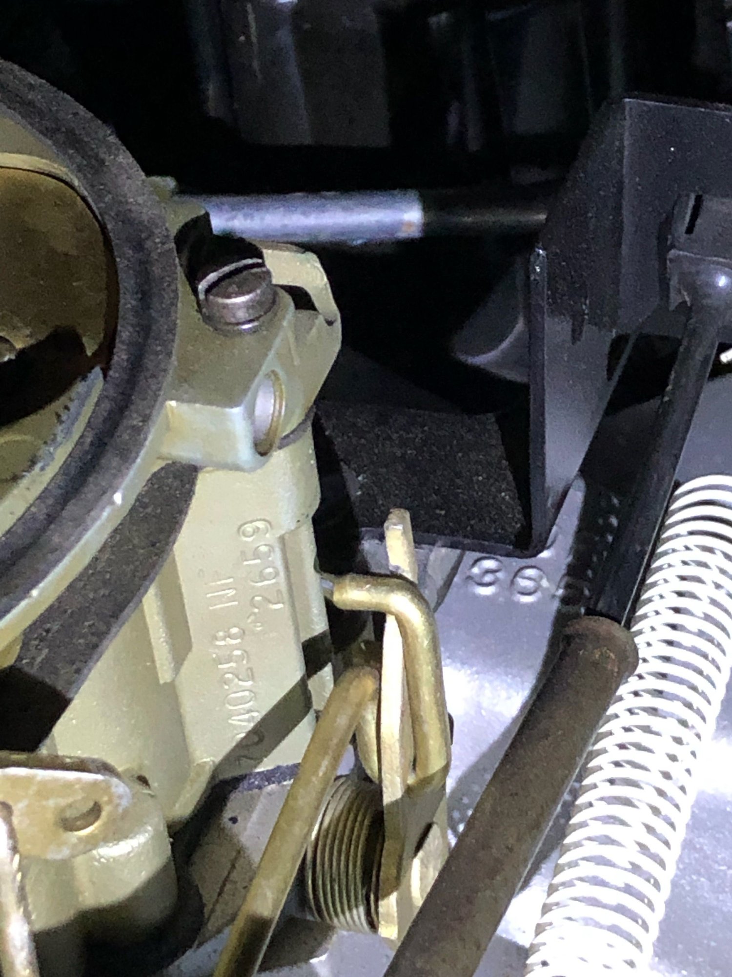

Carburetor 7040258, date code 2659.

That carburetor would not have come on that car. The date is much to old. At least I have not seen that late of a car with that old of a carburetor. It could have happened but very unlikely. I would like to see another picture of the carb numbers from another angle. You may want to post the carb number picture on the Re-stamp thread and get other opinions of the stamping. I am not sure on this one from that picture. Looks like a really nice car though.

Thank you for your information on the carburetor and your compliment on the car. I am most concerned about the OW stamp to confirm that the transmission is an OW and hasn't been restamped or altered.

carb
Hmm, a 258 carb with an "NF or NE" pick code ? don't think so...but just my .02
I agree. This stamping looks suspicious to me but I was not willing to say full restamp yet.

As far as I am aware all 1970 W30 Auto 7040258 carburetors were assembled in the same plant which is the "RK" code.
