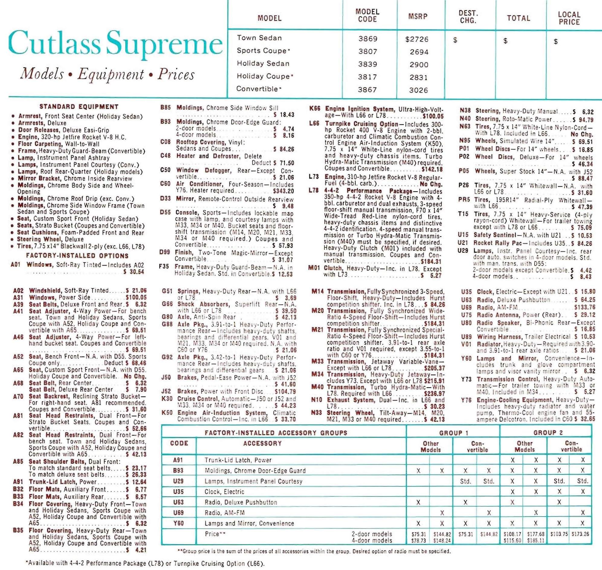

Posts: 50,806
Originally Posted by 69CSHC
Ok Joe I had to skim article again, I see why they call it Turnpike Cruiser, they are referring to the 1968 models that they compared to the stock 1967 models. As you said a 2.56 and 2.78 are considered economy gears.
The package was also called Turnpike Cruiser for the 1967 model year. Note RPO L66 from the 1967 SPECS booklet.
Old May 21, 2020 | 06:14 AM
69CSHC's Avatar
Posts: 2,089
Ughh I see and yes the article mentions that the gearing was reduced for 67 also. 7th paragraph first page. Overall specs listed don't indicate that...
So the 66 is a quicker car ? as the Autocat simulation indicates. Autocat also says standard feature gear for 66 320 HP was 3.08 with 2.78 optional when 2 sp.
