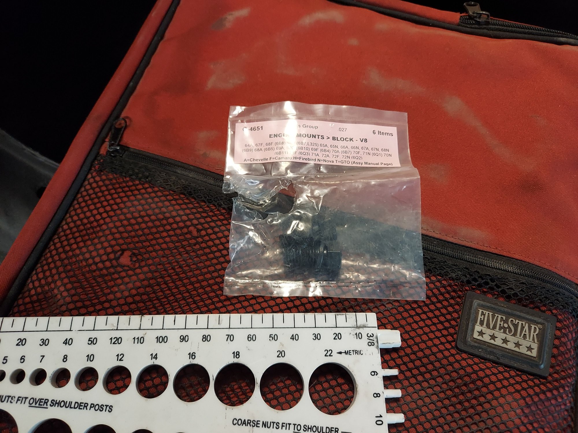

Ok mystery solved, once again Joe was correct.
After pulling the header and mount it was easily apparent the 3/8 16 bolt was not the correct one how the others got as tight as they did is a wonder to me. (Guess AMK 4651 v8 bolt kit is for chebby)
So off to find the correct 7/16 14 1 inch.

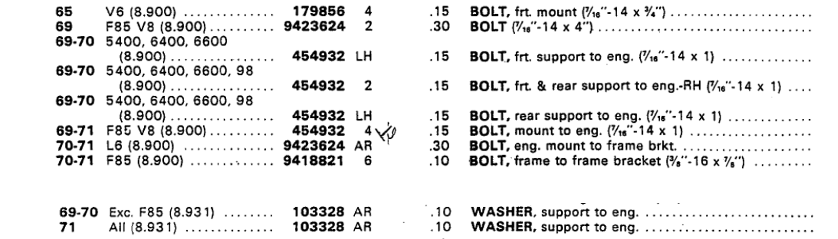

The parts book confirms 7/16"-14 x 1" long bolts and a washer.

Sorry, typo on my part, The parts book clearly shows 7/16-14. I don't know why I wrote it as fine thread. Doh! I edited the original thread.

I haven't spent enough time deciphering this thread for completeness; but, I was following along on your other thread and trying to determine deltas, if any; and, then, when you stated:
After pulling the header and mount it was easily apparent the 3/8 16 bolt was not the correct one how the others got as tight as they did is a wonder to me. (Guess AMK 4561 v8 bolt kit is for chebby)
Did you order the incorrect bolts by mistake? The reason I ask is because isn't the frame the motor mounts are sitting on a Chevrolet frame (judging from your other thread)?

I made the mistake of thinking v8 GM (chevelle) motor mount bolts to block were, all the same, AMK does not list olds specific bolt kits. Yes, it's a frame from a Chevelle but in this case, the motor mount to block bolts it's irrelevant.
From my understanding, the only difference is the motor mount frame pads are bolted to a different set of holes on the frame for chevy.
