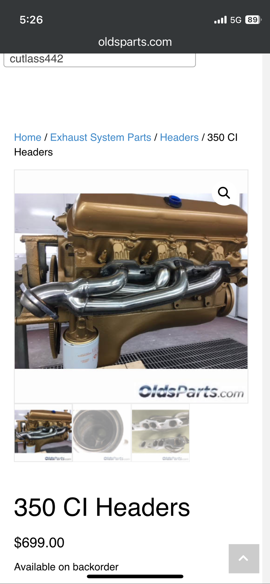

Has anyone used the custom headers from oldsparts.com? They look nice, are compact but pricey at $699. I can’t find any reviews or opinions on them but I am intrigued. I have a 69 cutlass that is in the rebuild process

Try these people, they made them.
https://www.thorntonmusclecars.com/p...***-350-engine

I bought Thorton shorty small block headers in 2019 and paid $270 shipped. I thought that was pricey at the time.
If you are looking for max power buy full size headers otherwise outside of the current price, I'd recommend them. They will connect right into the factory exhaust system with no mods.
I used Pypes Stainless Steel Exhaust Downpipes DOF10S and ran them into a 2 1/2 inlet muffler.
You can also install the headers while the engine is on the engine stand and drop right into the car.
My only complaint about them was they use metric exhaust bolt studs. (for connecting down pipes to the headers)

It's starting to seem that Oldsparts is the new (old?) Mondildo. Anything they sell is available from somewhere else, probably cheaper.

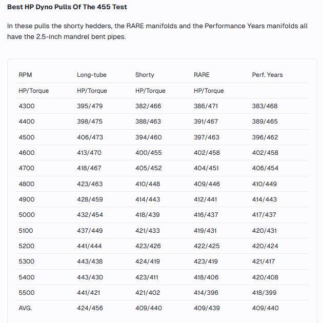

Originally Posted by v8al
Are you saying the lack of proof of a performance gain means there is no performance gain?
It's even worse than that. There is performance loss on occasion.
While people are entitled to their opinions, problems arise when opinions are presented as facts.
Here are facts.
https://www.motortrend.com/how-to/hp...-vs-manifolds/

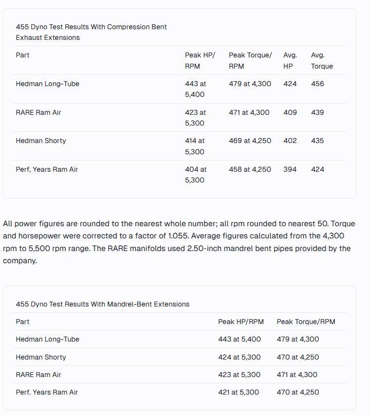

Old Jul 7, 2024 | 08:20 PM
69CSHC's Avatar
Posts: 2,089
Key quotes from the aforementioned article.
"Jim Wical at Hedman also warned that the shorties don't do much on a stock engine. I assured him that our 389 was not stock."
"I was told that the shorty hedders didn't do much on stock engines but less than logs was surprising. In another test performed by Terry McGean at Car Craft the shorties showed no horsepower gain over logs on a stock 455 but showed some torque increase (after mods the shorties performed well)."
With regards to the 455.
"Shorty headers do have a place in the line-up. In our second test with the mandrel-bent pipes they posted 1 hp better than the RARE manifolds and 3 better than the Performance Years pieces. They are much lighter than the manifolds and will provide some sparkle under the hood with HTC coating. On how they fit in an engine compartment we cannot comment since we did not install them in a Pontiac chassis."
I read that last paragraph as, they are a "feel good item".
Here are facts.
im not sure you realize it or not..that’s a Pontiac 😂😂😂
so those facts, are meaningless…not only because they are cast iron, not the stainless individual runner pipe style shorties this is about.
you are a clueless..im being nice
Here are facts.
this guy is full of it…Im being nice

Originally Posted by Olds64
Interestingly, nobody has mentioned if the Oldsparts.com headers fit without modification with a BFH. I @$$ume they'd fit a Cutlass since they are shorties. Probably not a Cutlass S though.
Usually people make comments when they don't fit. I didn't have to do any massaging when installing the Thorton 350 headers in a 72 Cutlass w/AC.
the truth is that price is way up there. I’ve seen them used for less than half that..which is worth it. the truth about the performance advantage is they are much much better than the factory small block exhaust manifolds… especially when used with 2.5” down pipes. they are also better than the Thornton cast iron small block split flow manifolds which are the same price…those need a lot of grinding to be made usable because they a poor Chinese castings
some guys just hate headers hanging down under the car, especially if it’s at stock ride height.
don’t get caught up in the internet hate for these things..think clearly, look at them as an in between solution to full length headers and stock iron olds manifolds
that test done on the Pontiac engine does NOT apply to the small block Olds..not even close
if you need more explanation, just ask. Here’s a test with them in a small block compared to Thornton cast ones and long tubes..they did very good
