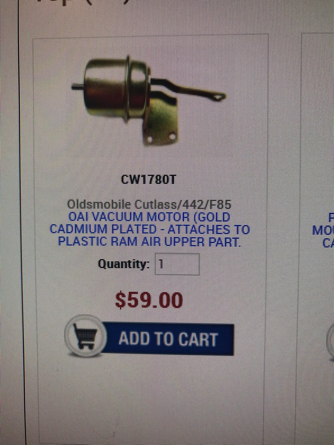

I bought mine from Supercars Unlimited but I've heard that the owner has some medical issues and is not fulfilling orders. You can also get one from the Parts Place. Here is the listing on their website.

Go back and look at post # 6 in this thread for a couple of options to buy the part.

Sweet. Ty. Somehow I missed that.
