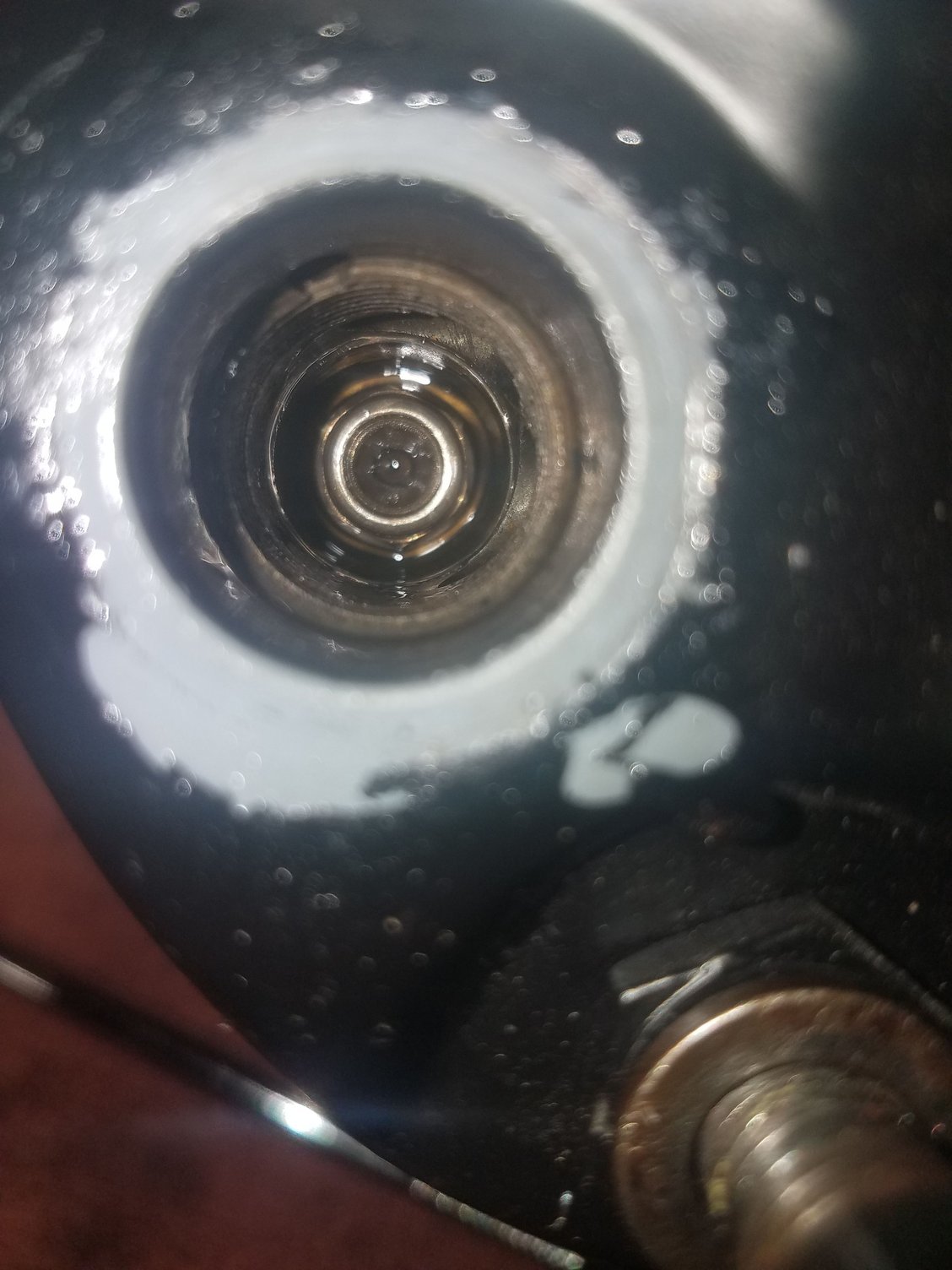

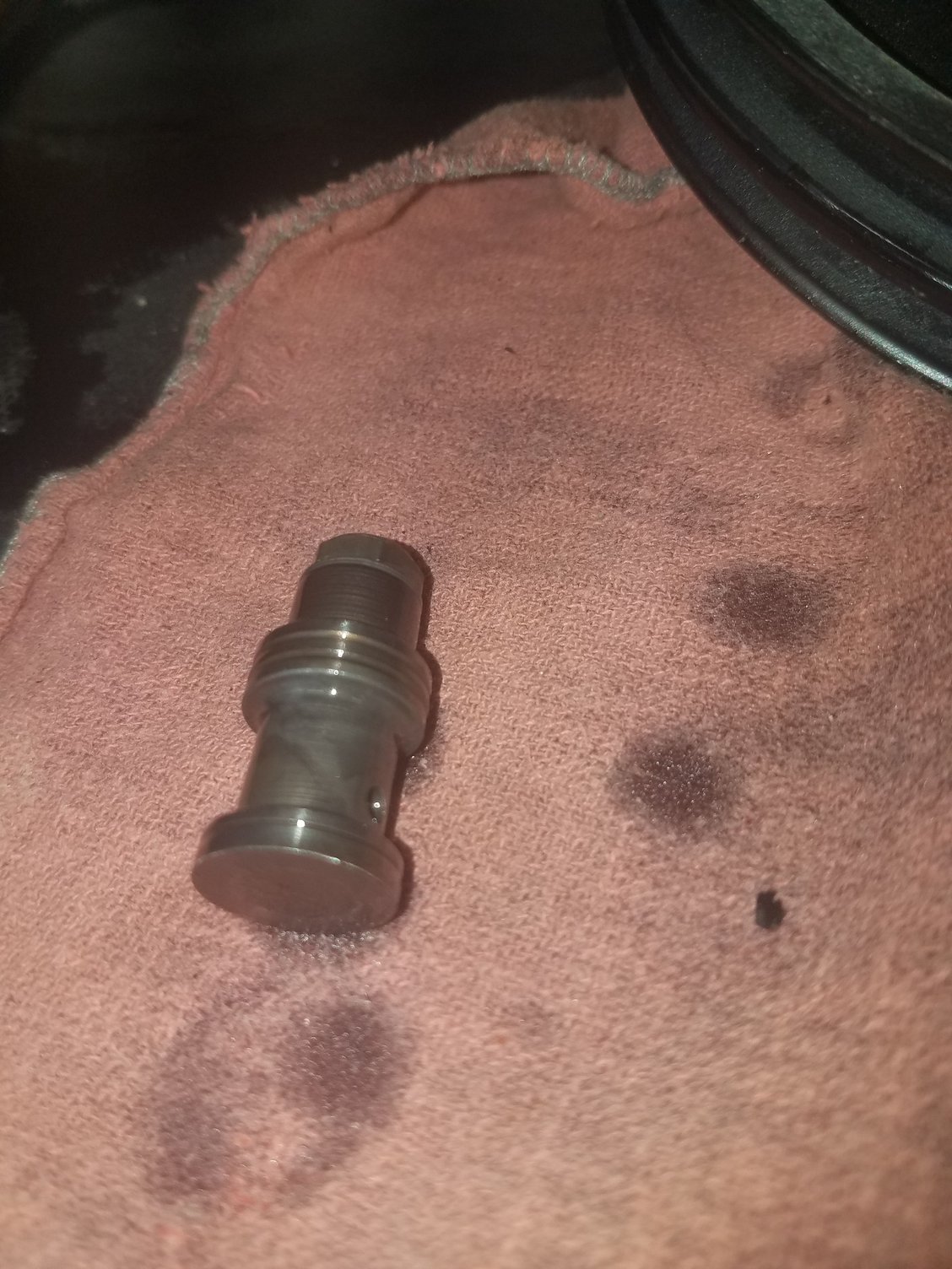

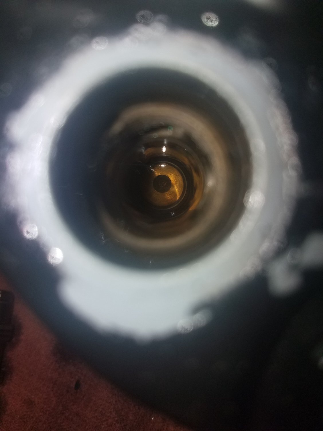

Hey, thanks for the help so far. Work and family kept me away for a bit, but I got a chance to try see if the valve needed freeing up. Pushing a rod into the hold and pushing hard met firm resistance, absolutely no give. I couldn't see anything on the car, so pulled the pump. The service manual says that when removing the 1" hex headed union from the pump body to watch out for the flow valve to pop out from spring pressure. Nothing popped (first clue!). Looking into the pump I could see a hex headed shape (second clue!) - the service manual states to make sure when inserting the valve into the pump body to insert the hex end first. I was able to convince the valve to come out, to discover that there was no spring behind it - that is because the spring was installed after the valve.
Basically, the order of assembly should be spring-valve (hex end first)-adapter fitting. This pump was assembled valve (flat end first)-spring-adapter fitting.

Hex Head End - Installed Backwards
Valve Out of Pump
No Spring Behind Valve
